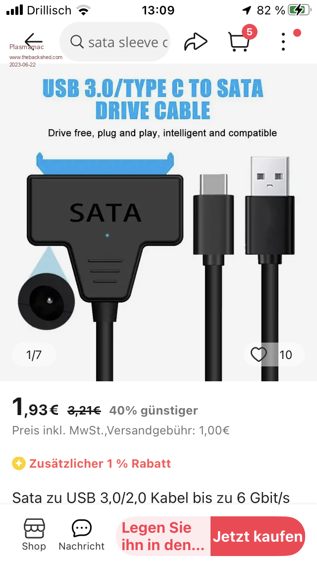

Posted: 11:10am 22 Jun 2023
Try this
Plasma

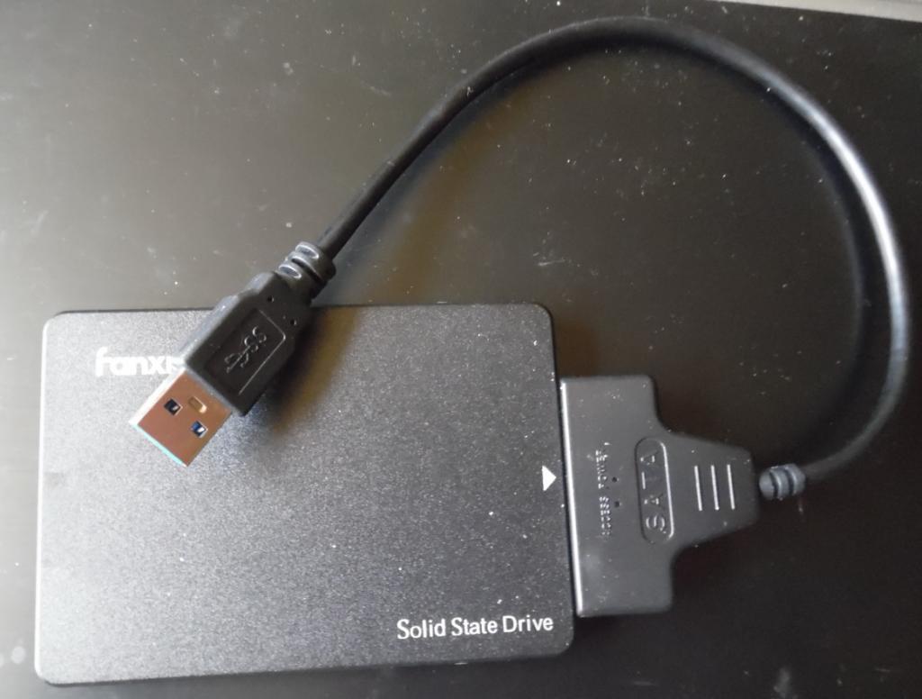

Sata to usb is cheap. I'm wary of usb ssd cases as I had a ssd fail in one.

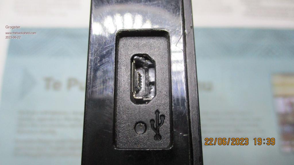

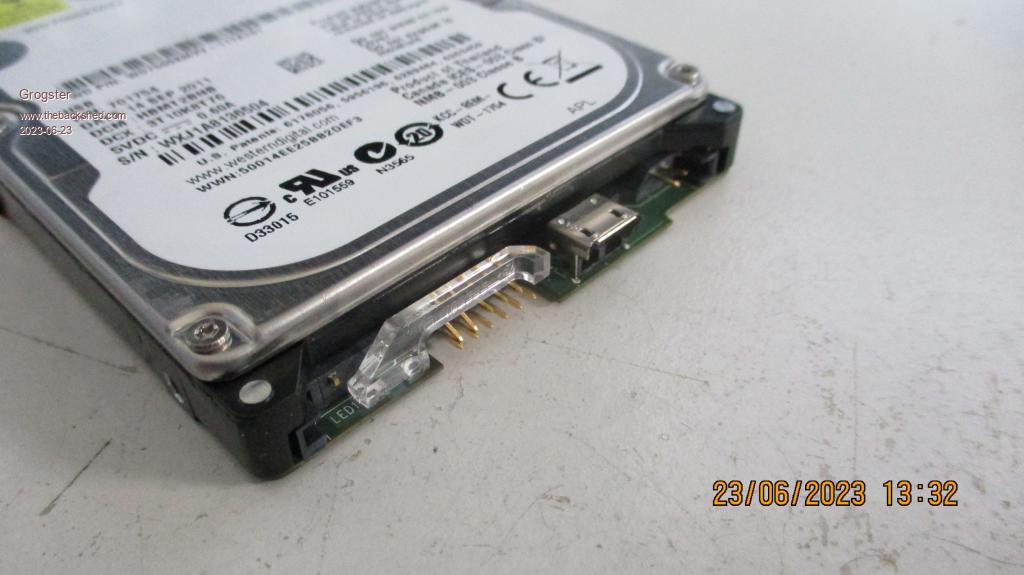

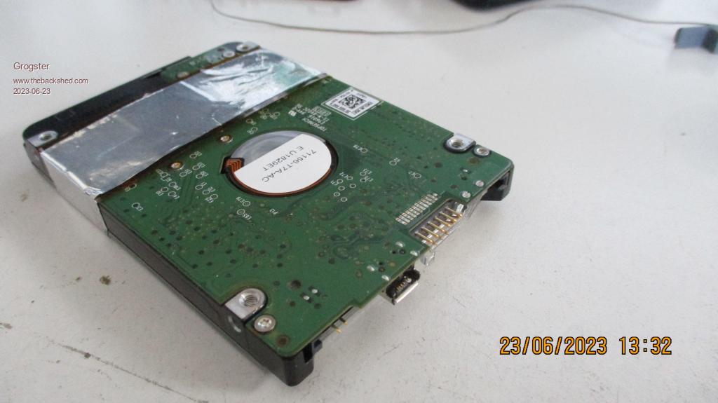

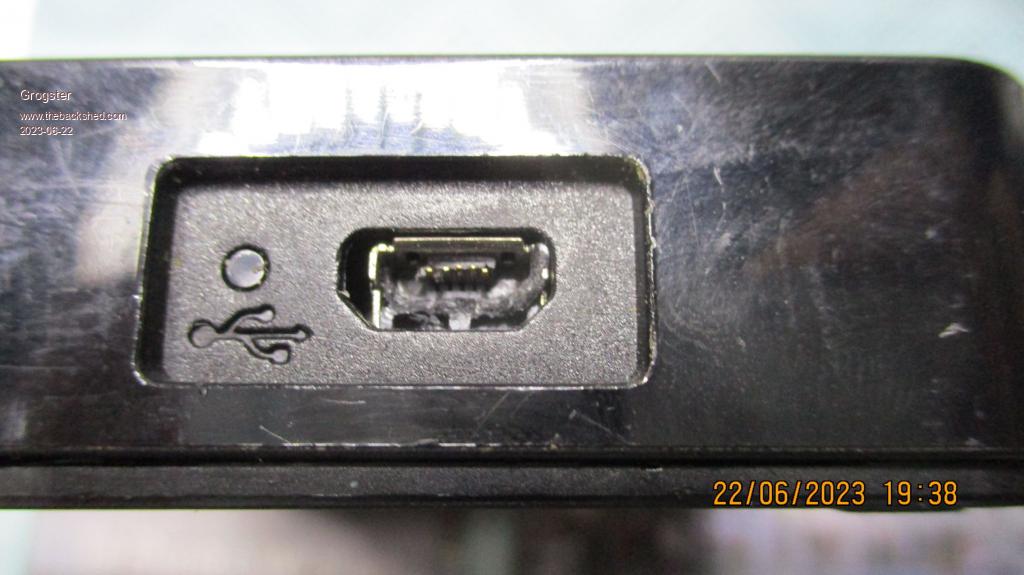

Thanks for all the comments, chums, but this is a WD drive - one of those short ones that is about the same size as a 2.5" HDD, and the USB interface is PART OF THE HDD PCB.  You CANNOT remove the drive, and put it in any other kind of case, you cannot use those SATA to USB adaptor cables - there IS no SATA port to connect to on these drives.
I seem to recall reading somewhere where you CAN solder to certain points on the PCB to get access, but as Mick and others have said, is it really worth it?  Probably not.
It is a 750GB drive, so I guess it depends on how much stuff is on it and of what value it is, to work out if recovery is worth the effort.  At this stage, they think all they need is a new cable.  They won't be prepared for me to tell them the drive is going to be very hard to even use again, cos of how badly damaged the socket on it is.
EDIT: Here are a couple of photos.  Moving to another case or using a SATA cable are impossible on these WD designs.
I have no idea what the dual-row of pins are for, but I seem to recall they are NOT the SATA interface.  I will have a we look around on Mr. Google, cos I know I have seen people hack these drives to get access, but it was years ago.
Note how you can't even access the back of the USB socket, so even soldering a cut-off USB cable to the PCB is not really even possible at first glance.

Posted: 01:18am 23 Jun 2023
Hi Grogs,
Possibly yet another daft idea but, only if you enjoy a challenge:
How healthy are the pins in the socket?
Can you pare back any interfering plastic, get a USB plug to make contact and wedge it in place - at least long enough to retrieve the data?
If that works you might leave the wedge(es) in place and glue it in permanently?
(Edit: It may even be possible to use the glue to make a bigger plug to fill the whole of the butchered socket so it still removable?)
Cheers,
Andrew
Edited 2023-06-23 11:22 by Andrew_G
Posts: 9996
Posted: 03:38am 23 Jun 2023
Excellent idea, Andrew, I will make the attempt.
At the moment, the micro-USB plug won't even slide in there, as the plastic carrying the contacts, is bent hard against the chassis of the socket.
As you say though, I might be able to use a knife to GENTLY bend it back out just a tad.  I only need a fraction of a mm, to be able to get the shell of the micro-USB plug in there, then we MIGHT be able connect to the drive.
I like your glue idea, and if the above works, I would indeed secure the plug permanently in place - and tell them to buy a new external USB HDD and copy everything off this one ASAFP!!!!

Plugging a USB cable into my problem one DID WORK!
I am copying everything off it now, to a more standard HDD with a STANDARD f-ing SATA port.

IT IS MICRO USB!!!!
The socket on it is so phucked up, you might not have spotted that.

It's that badly mangled I thought it was a mini...  lol Maybe it was a micro to mini conversion. :)

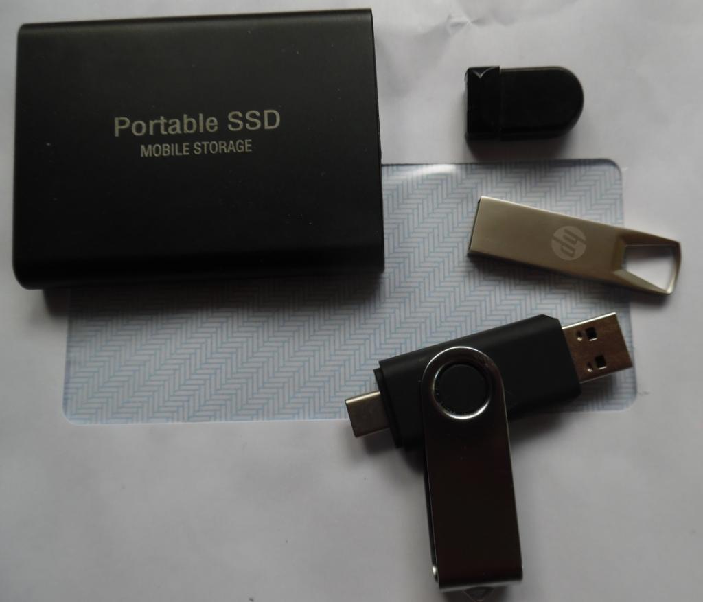

I bought a 2TB usb drive recently but it really is 16GB. When it fills up it deletes the contents of the first file but not the file, so you don't know until you try to open it. I got a refund.
