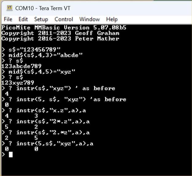

V5.07.08b5
Changes to WebMite as per this thread
Other new functionality.
The MID$ command can now insert a string that is a different length than the selected section
Full, optional implementation of regular expressions in INSTR and LINSTR
INSTR([start],text$, search$ [,size])
LINSTR(text%(),search$ [,start] [,size]
In both cases specifying the size parameter causes the firmware to interpret the search string as a regular expression. The size parameter is a floating point variable that is used by the firmware to return the size of a matching string. If the variable doesn't exist it is created.

I am seeing some issues with the new regex version of the INSTR function. I have tried a clean and reload of the b5 firmware but can still get the same results. There are a number of ways it manifests.
This shows it working as expected after power restart,
but relies of the INSTR function nominating the START position to be
run first.
PicoMite MMBasic Version 5.07.08b5
Copyright 2011-2023 Geoff Graham
Copyright 2016-2023 Peter Mather
> ? instr(1,"123xyz789","x.z",a)
4
> ? instr("123xyz789","x.z",a)
4
