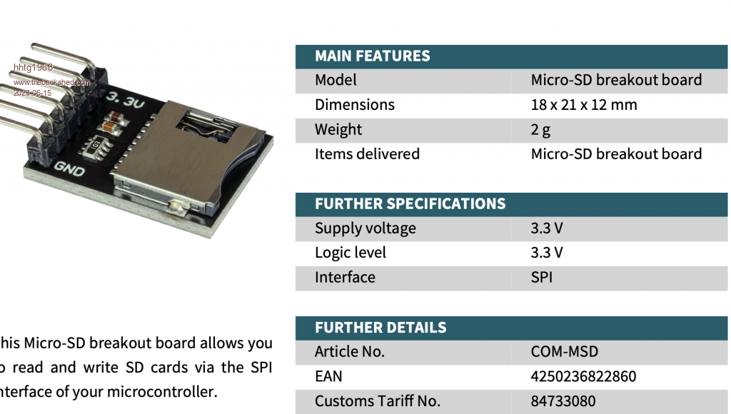

hello. a few days ago this forum helps me to connect a sd card reader (5v) to picomite via a level shifter... now i have bought a 3.3v reader. see tech specs on foto. but the access is not reliable. the reader is correct connected. sometimes there are no problems, sometimes i get "no sd card found", sometimes i get "hardware problem ... wrong FAT". the files command shows kind of corrupted inventory. i tried to repair the sd card with my computer, but there is the card with no mistakes... back to picomite... and all functions super. one hour later problems again... if i use the 5v reader there are no problems. perhaps i should send the 3.3v reader back to the dealer... |

That uSD card reader seems to have 1k series resistors on the signal lines. It's unlikely to work. 3V3EN is 3V3 ENable - you pull it low to switch off the 3V3 supply. :) Mick Zilog Inside! nascom.info for Nascom & Gemini Preliminary MMBasic docs & my PCB designs |
| Amnesie Guru Joined: 30/06/2020 Location: GermanyPosts: 763 |
If it isn't a contact problem (micro sd-socket ?) I guess the resistor network on the pcb is the problem. If you already use 3v3 you don't need a resistor network at all. Maybe it pulls the voltage down. Greetings Daniel |

1k series? I see a 10k resistor array, most likely for pull-ups. Might be the one available from here. Unfortunately no circuit diagram is offered. Visit Vegipete's *Mite Library for cool programs. |

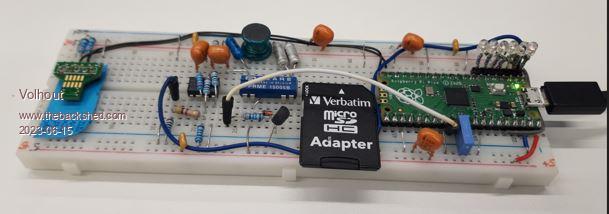

| Volhout Guru Joined: 05/03/2018 Location: NetherlandsPosts: 5998 |
Breadboard friendly header... Connectig jumper wires invisible, under pico and under card adapter. Just solder 7 right angle 2.54mm header pins to the card adapter... Edited 2023-06-15 22:11 by Volhout PicomiteVGA PETSCII ROBOTS |
| stanleyella Guru Joined: 25/06/2022 Location: United KingdomPosts: 2807 |
soldering wires to sd card?!?! |
| JohnS Guru Joined: 18/11/2011 Location: United KingdomPosts: 4355 |
I think it's not - it's to the adapter. You insert the card afterwards. I like the idea! John |
| Mixtel90 Guru Joined: 05/10/2019 Location: United KingdomPosts: 8973 |
No, it's a micro SD card adapter. It doesn't seem to be labelled in Welsh. ;) Edited 2023-06-16 04:10 by Mixtel90 Mick Zilog Inside! nascom.info for Nascom & Gemini Preliminary MMBasic docs & my PCB designs |
