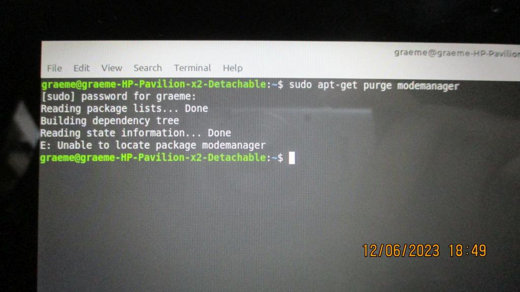

You might have to get rid of modemmanager
sudo apt-get purge modemmanager
The commands to get rid of it may vary. Search the forum.

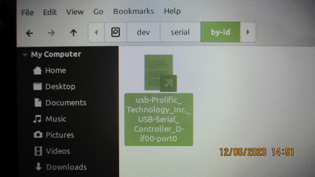

dmesg result is HUGE, so I can't take a photo of it.  Is there a command to make it save the result as a text file somewhere I can copy it from?  It may not be needed anyway - see below...

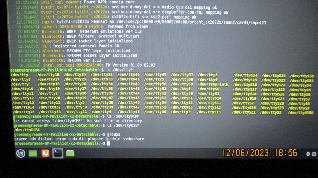

@ Quazee137: This is the output I get from those commands...
From what I can tell from this, I am already a member of the dialout group, and I think the Prolific adaptor is at /dev/ttyUSB0.
Inside PuTTY, I cannot select /dev/ttyUSB0.  All it will let me select is /dev/ttyS0.

Modemmanager,
NOT
modemanager!
Posts: 10072
Posted: 07:14am 12 Jun 2023
Yes, I should have thought of the loopback test!
However, I had a thing on the bench ready to connect to it, which I knew worked on the same Prolific adaptor and a Windoze laptop, so....
  Quote  Modemmanager,
NOT
modemanager!
F-ing Linux!
Totally missed that extra "m" - very well hidden.....
In any event, it did not seem to matter, as the COM port is working now.

I have now removed modemmanager using the extra m this time.  It completed without errors, so that should now be gone.

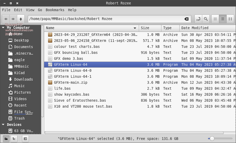

EDIT: @ Rob - Can download the file, but Mint does not know what to do with it.  Mint moans that the file has no application associated with it.  The file has NO extension, and the W10 machine I downloaded it on, just refers to it as filetype "File".
Do I need to rename and add an extension perhaps?
Edited 2023-06-13 10:26 by Grogster
Posts: 2552
Posted: 02:21am 13 Jun 2023

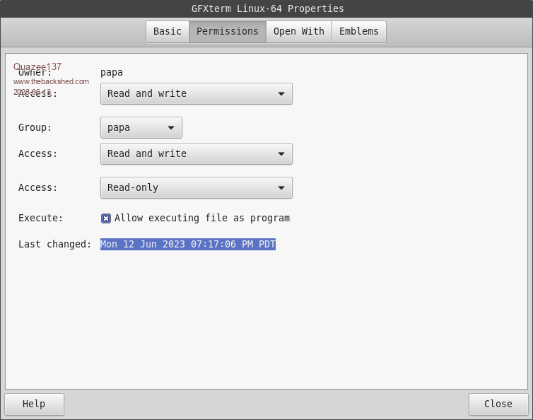

right-click on the file's icon and select 'Properties' from the menu. this will bring up a window with three tabs, the right-most is the one you want, 'Permissions'. here you will find a checkbox with the text "Allow this file to run as a program".
check this checkbox, this will then allow the file to be run.
with linux, extensions don't have any special meaning in the same way as they do with windows, so no need to rename anything.

bring up nemo or other file mgr you use
right click on
click box
from here on in it should just run.
