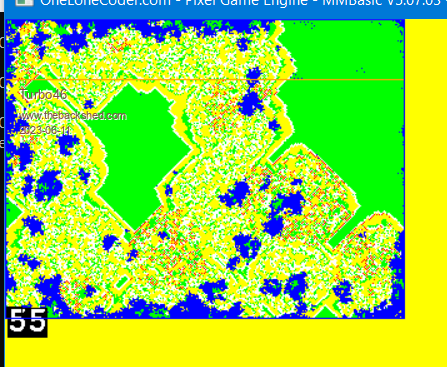

Yes MMB4W does have graphics, this is a display:
It only displays on a small section of the screen. I've not tried it on the CMM2 yet.
I see that you are using a Mac so MMB4W is not so easy. The program just starts and it's not clear what is happening if you don't already know. If the start screen shows something like:
