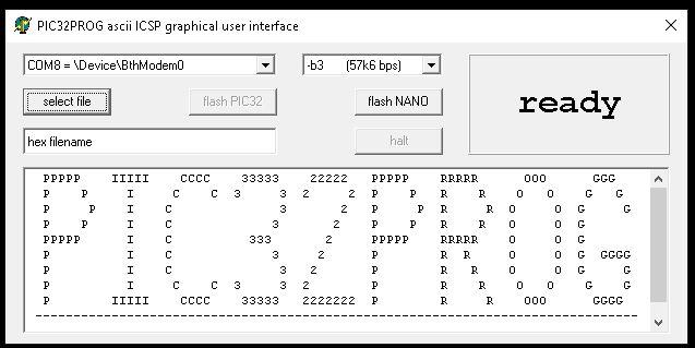

  the simplest way (under windows) is to use p32p_gui from here:
http://www.thebackshed.com/docregister/ViewDoc.asp?DocID=21
ensure that "pic32prog.exe" and "P32P GUI.exe" are both in the same folder, along with any .hex firmware file you wish to upload to your pic32.
double-click on "P32P GUI.exe" to launch the program. select the comm port that the nano is attached to from the dropdown menu, then click on the 'flsh NANO' button. all going well, the 'ascii icsp' firmware should be uploaded to the nano (ensure that there is no jumper on the nano's RESET pin).
now you can use the 'select file' button to select the .hex file to write to the pic32, then click on the 'flash PIC32' button to upload it.

Many thanks for the P32P_GUI.exe. To save me guessing wrongly - how do I use it?

To use PIC32GUI.exe, simply copy it and pic32prog.exe into the same folder(that should be the case now), and double-click on PIC32GUI.exe.
Windoze MIGHT moan about it not being an approved app.  If you get that, click on "More information" or "Tell me more" - something like that down the bottom of the window(it's a text-type link, not a button), another window will open, and in that one click "RUN ANYWAY".  You only have to do that once.  Windoze will remember for the next time.
Select the COM port from the drop-down list box at upper-left of the window that opens, press the SELECT button on the E100(MODE LED should light AND STAY LIT).
Click on select file, locate and open the HEX file for the firmware you want to load.
You should be brought back to the GUI window, from there, click on flash PIC32
Everything SHOULD just flow nicely from that point on.  Keep us updated.

Sorry about the delayed response to this thread. Having run "P32P GUI.exe" I get exactly the same message as above.
I have reseated the '1455 in case there was a problem there, but no joy.
