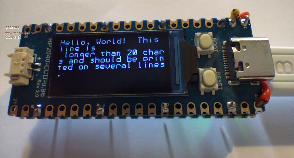

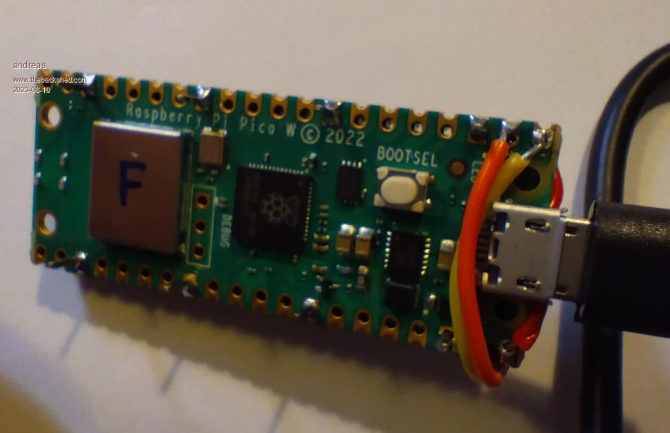

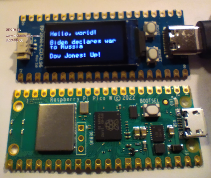

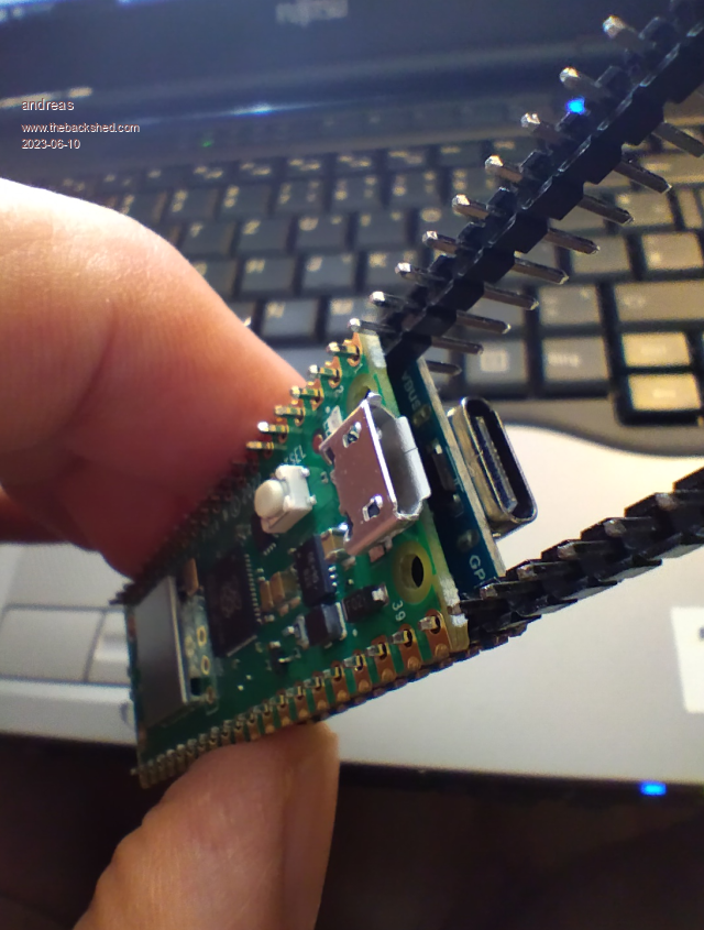

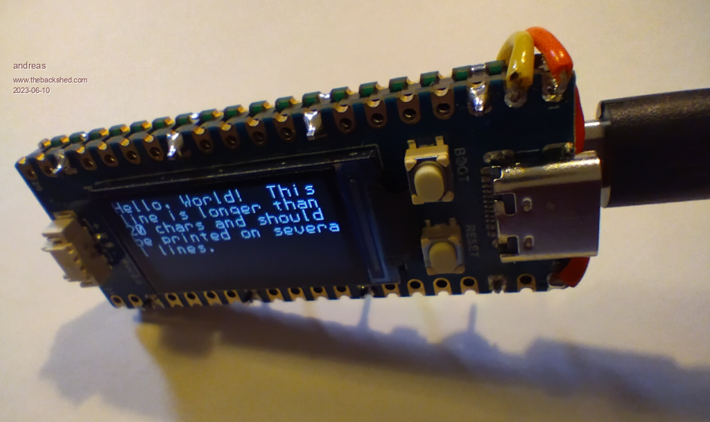

here it is: The WebMiteLCD :-)
Step1: putting them together this way
WebMite on top, RP2040LCD on the back
Soldered are: GND(8x),VBUS,GP0 and GP1 (Null modem, crossover)
All other header pins are dragged out after soldering GND lines

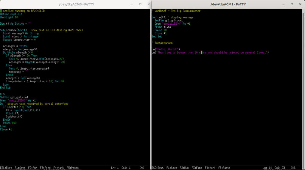

Step2: The Software
Left side: RP2040LCD showing everything received by COM1:
> list
' ser2lcd running on RP2040LCD
Option explicit
Backlight 10
Dim t$ As String = ""
Sub lcdshow(text$) ' show text on LCD display 8x20 chars
 Local message$ As String
 Local mlength As integer
 Static linepointer = 0
 message$ = text$
 mlength = Len(message$)
 Do While mlength > 0
   If mlength >= 20 Then
     Text 0,linepointer,Left$(message$,20)
     message$ = Right$(message$,mlength-20)
   Else
     Text 0,linepointer,message$
     message$ = ""
   EndIf
   linepointer = (linepointer + 10) Mod 80
 Loop
End Sub
CLS
SetPin gp1,gp0,com1
Open "com1:115200" As #1
Do ' display text received by serial interface
 If Loc(#1) > 0 Then
   t$ = Input$(Loc(#1),#1)
   Print t$;
   lcdshow(t$)
 EndIf
 Pause 100
Loop
Close #1

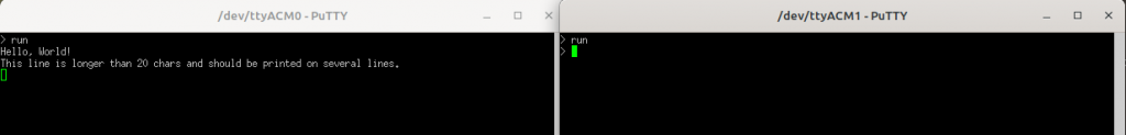

Right side: WebMite sending a text$ to COM1:
> list
' WebMiteF - The Big Communicator
Sub dm(t$) ' display message
 SetPin gp1,gp0,com1
 Print #1,t$
 Pause 10
 Close #1
End Sub
' Testprogramm
dm("Hello, World!")
dm("This line is longer than 20 chars and should be printed on several lines.")
-andreas

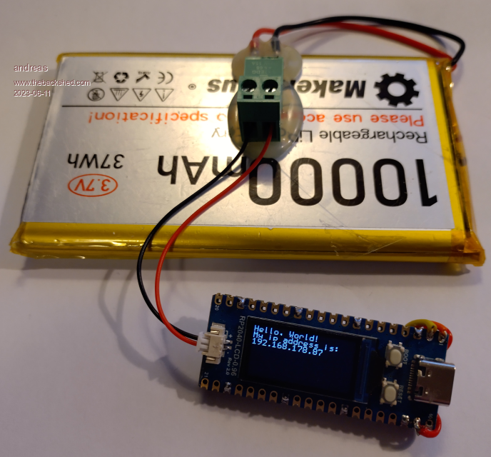

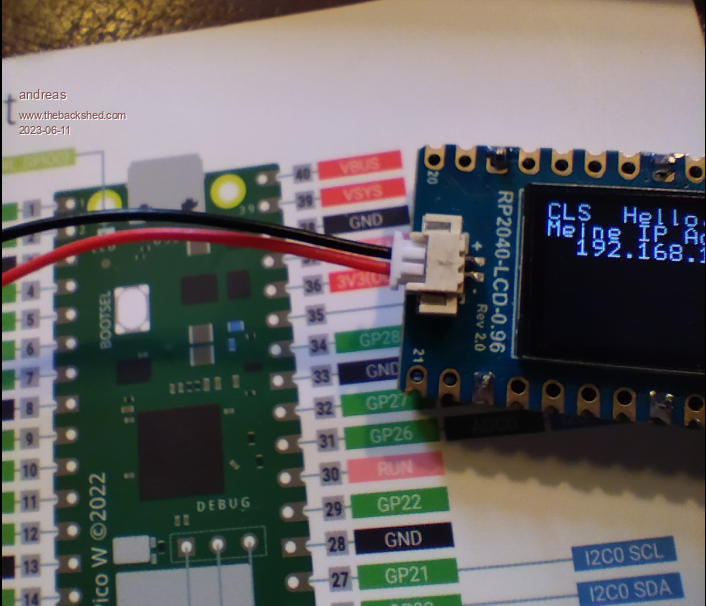

Today I have received tiny cables with a connector fitting into the tiny accu connector of the RP2040. The colours are wrong (black and red!). Then I saw that it would be better to connect VSYS to VSYS and not VBUS to VBUS as I did it. The diode seems to "protect" the WebMite pico w from power sourcing from the battery connector of the RP2040. So I will change that hardware design.
-andreas

My current working version WebMiteLCD with "EXECUTE" capability:
Sender (WebMiteF = pico w)
' dm-lines starting with "!" will be executed as BASIC code from the LCD unit
 SetPin gp1,gp0,com1
 Print #1,t$
 Pause 10
 Close #1
End Sub
Sub clearLCD() ' clear LCD
 dm("!CLS")
 dm("!linepointer = 0")
End Sub
' Testprogram(m)
clearLCD
dm("Hello, World!")
dm("My ip address is:")
dm(MM.Info(ip address))
Receiver (RP2014LCD)
Option explicit
Dim command$ As String = "" ' command to execute if line starts with a "!"
Dim linepointer As Integer = 0 ' line to write the next line of text on the LCD
Backlight 10
Dim t$ As String = "" ' received message
 message$ = text$
   Else
     message$ = ""
   EndIf
 Loop
End Sub
' main program
CLS
SetPin gp1,gp0,com1
 If Loc(#1) > 0 Then
   Pause 5 ' ms time to read the message
   If Left$(t$,1)="!" And Len(t$) > 1 Then ' it is a command
     command$ = Right$(t$,Len(t$)-1) ' take the rest of line
     Execute command$
     command$ = ""
     t$ = ""
   Else
     lcdshow(t$) ' display normal text
     t$ = ""
   EndIf
 EndIf
Loop
Close #1
Example:
Options Sender:
WebMite MMBasic Version 5.07.08b2
OPTION AUTORUN ON
OPTION LIBRARY_FLASH_SIZE  14000
OPTION COLOURCODE ON
OPTION DISPLAY 50, 100
OPTION WIFI FlitzBox, *********************
OPTION TELNET CONSOLE ON
Options Receiver:
PicoMite MMBasic Version 5.07.07
OPTION SYSTEM SPI GP10,GP11,GP28
OPTION AUTORUN ON
OPTION HEARTBEAT OFF
OPTION LCDPANEL ST7735S, LANDSCAPE,GP8,GP12,GP9,GP25
-andreas

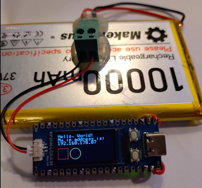

..even graphics is working:
 SetPin gp1,gp0,com1
 Print #1,t$
 Pause 10
 Close #1
End Sub
 dm("!CLS")
End Sub
' Testprogram(m)
clearLCD
dm("Hello, World!")
dm("!Box 0,40,30,30,,rgb(red)")
dm("!Circle 50,55,15,1,1,rgb(yellow)")
-andreas
Posts: 3885
Posted: 08:19pm 10 Jun 2023
Better and better.

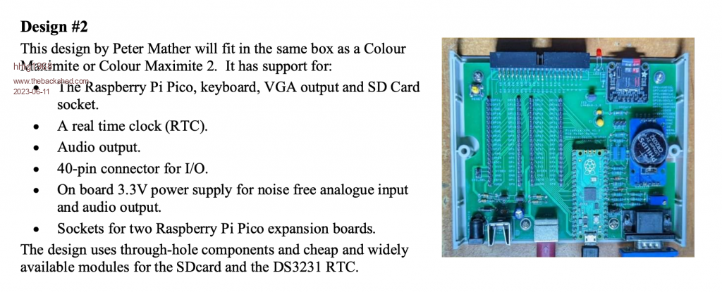

hhtg1968
Joined: 25/05/2023
Posts: 248
Posted: 09:03pm 10 Jun 2023
when i read about the dream of Andreas i remember the design #2 from geoffg´s site of the picomitevga. look at the foto...

He doesn't. Note that it says "Sockets for two Raspberry Pi Pico expansion boards."
They are wired in parallel with the PicoMite so you can plug in expansion modules as if they were "hats" on a Pico. You can't have two "active" devices with all the IO pins connected together, such as two Picos.
If you want to link two or more PicoMites then it's relatively easy to use I2C to send messages between them. I did a board (the PicoMite Pear) a while ago that links a standard PicoMite with a PicoMite VGA. I was just looking and I don't think I put it on my Dropbox... I'll try to sort that out later.
