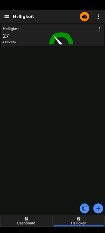

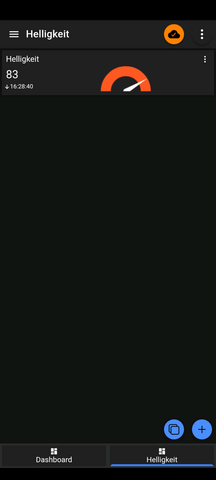

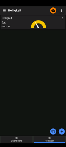

With the latest WebMiteV5.07.08b2 it works and values can be made visible using IoT MQTT panel:)
