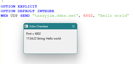

Hi, ive testet the webmite udp with a ip adress outside my homenetwork. No success atm. Have anyone tested this also?

try sending a UDP message to tassyjim.ddns.net port 6802
It only accepts messages one at a time.
I will add some logging later.
It is also running on a part of my network I don't normally expose so it will not be there for long.
That's going trough two NATs

I have now put a WEBmite on the net.
It is running a slightly modified version of Peters example.
 OPTION EXPLICIT
 OPTION DEFAULT INTEGER
 DIM remoteIP$, n, lastTime$
 WEB UDP INTERRUPT myUDPint
 'WEB UDP SEND "tassyjim.ddns.net", 6802, "Hello world"
 DO
 LOOP UNTIL n > 100
SUB myUDPint
 PRINT "received "+MM.MESSAGE$+" from "+MM.ADDRESS$+" at "+TIME$
 IF remoteIP$ = MM.ADDRESS$  AND LEFT$(lasttime$,5) = LEFT$(TIME$,5) THEN
   INC n
 ELSE
   lastTime$ = TIME$
   n = 1
 ENDIF
IF n < 10 AND LEN(MM.MESSAGE$) < 200 THEN
 WEB UDP SEND MM.ADDRESS$,6802,MM.MESSAGE$+" at "+TIME$
ENDIF
END SUB
The biggest risk with having a simple server on the net is how easy it would be to end up with a race condition where a message gets bounced back and forth eating up all your bandwidth and eventually getting banned by your ISP.
The above code should limit a user to 10 hits in any minute.
Not very sophisticated and I will do more but it would be silly announcing the code. That would make it too easy for anyone wanting to play silly games.
Code at the other end is:
OPTION EXPLICIT
DO
LOOP
SUB myUDPint
END SUB
It just sends one packet and prints the reply.
This will test your router to see if it has port triggering or port forwarding set up.
Posts: 6626
Posted: 02:20am 03 Jun 2023
  Quote  received Hello world from 92.xxx.xxx.xxx at 12:17:11
Did you get the reply?
(Local time which is 02:17 UTC)

Posts: 6626
Posted: 05:38am 03 Jun 2023
I received plenty of packets and when I tested it, I was receiving replies OK.
The replies are sent to your public IP port 6802 so it looks like you need to check your router port forwarding
That's the trouble with UDP, not easy to know if it works.
Edit: I can't ping the 92.xxx.xxx.xxx address and a trace gets lost in telefonica.de
Edited 2023-06-03 15:42 by TassyJim
