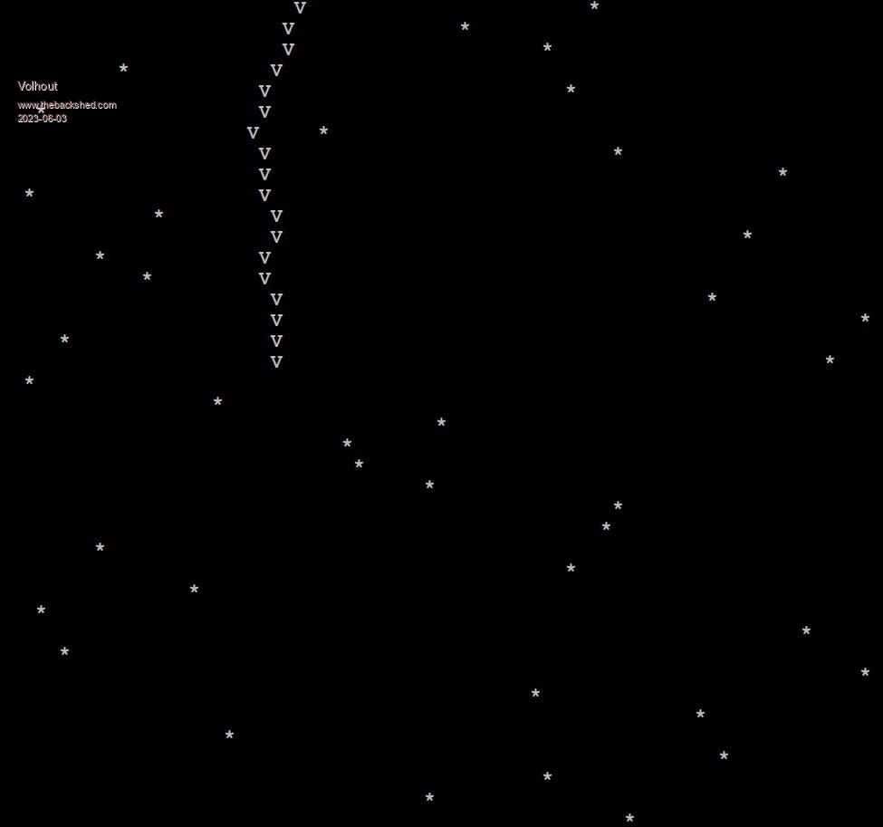

A complete game in one line......
Based on : C64 oneliner
Try to maneuver your spaceship "V" between the stars "*". For VGA Picomite in mode 1. You start your journey on the left side of the screen. Use left and right arrow to maneuver. Start with right arrow, or you will be flying in another universe...
1 Text 8*c,84,"V":Pause 99:b=Asc(Inkey$):c=c+(b=131)-(b=130):a%=80*Rnd():Print @(8*a%,468)"*":If Pixel(8*c+4,89)=0 Then 1
This version works for all picomites through terminal (tested on Putty). It is slightly longer.
1 Print @(8*c,84)"V":Pause 99:b=Asc(Inkey$):c=c+(b=131)-(b=130):a%=80*Rnd():Print @(8*a%,468)"*":If Pixel(8*c+4,89)=0 Then 1
You can shrink the game to an absolute minimum, but then you exit the game with an error. PicomiteVGA only.
1 Text 8*c,84,"V":Pause 99:b=Asc(Inkey$):c=c+(b=131)-(b=130):a%=80*Rnd():Print @(8*a%,468)"*":GoTo Pixel(8*c+4,89)+1
Happy playing....
P.S. the trick is to PRINT a new "*"<CR> at the bottom of the screen, so it starts to scroll. TEXT will not do this.
Edited 2023-06-03 17:42 by Volhout
