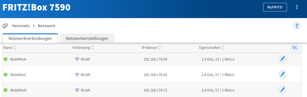

Hmm my vodaphone router hasn’t this option so i edit the Webmite ascii   in the uf2 file. Works

. Ja
