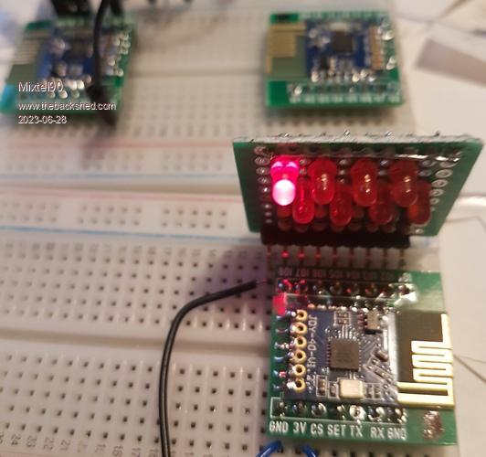

EDIT:
YAY! My little breakout boards for the JDY-40 work. They let you plug them into ordinary breadboards, with all connections on pins.
Incidentally, I had no luck in attempting to program the JDY-40 using Tera Term. I used YAT, which had no problems at all. I suspect that Tera Term is sending character by character and YAT sends a complete line terminated by CR LF.

In my experience by using µC boards, the USB serial drivers FTI, CDC, CH34* etc. also chop up the data stream differently.
In my opinion is termination by LF (or CRLF) in any case where it is possible a good practice.

I was using the same CH134, by the way, so it didn't seem to be a problem there. The JDY-40 insists on capitals and /r/n line termination. YAT is intended for programming embedded controllers etc. It's not strictly a terminal emulator.
