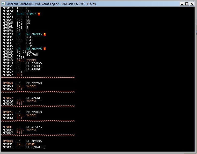

I wrote yet another Z80 disassembler (in MMBASIC4W). With undocumented instructions implemented.
It reads bin files (*.sna for example) and disassembles them, of course.
Now I would like to test it against errors. (I tested against some *sna files and it looks OK, but for example Ms.Pacman uses not so much undocumented instructions)

But I do not like unnecessary tabs! :D
Take a look, what my program outputs :
Basicly, the job is done in both ways, but I want formatted text like I prefer. (not the straight-forward way)
And for this reason, I preformed ED, FD, DDCB mnemonics in text files (tabs, spaces) in advance, so I would only replace 'NN' , 'N' values later. Now to reach what I want I use LEFT$, RIGHT$, but with pattern serach/replace, for ecample '#NN#' replace with '46009' final program would be more elegnat and easy to read and understand to somebody. Thats all buzz about :D
