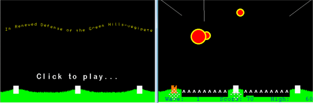

Here is VegiPete's "Renewed Defense of the Green Hills" #2, (a variation of Missile Command) converted from CMM2 for the PicoMite using an ILI9488 for the display and touch instead of a mouse. I had previously converted it for an LCD on the Armmite F4, but there were still some changes required.
The only real non-cosmetic change was to reduce the number of missiles from 48 to 32 because the PicoMite didn't have enough memory. Even when running the PicoMite at the top speed, with "OPTION CPUSPEED 378000", the pace of the game is, say, stately--just about right for my motor skills. (Note that "OPTION GUI CONTROLS 40" is needed for touch to be enabled.)

The color rendition of the video is terrible. I tried the cameras on two cell phones, and what is green to the eye and when the phone is two inches from the LCD is white when it is far enough away to frame the entire LCD. The orange with yellow bordered explosions are also not rendered accurately.

I ran up to wave 12 before I lost a base station and the program crashed with an array dimension exceeded while trying to erase the missile supply for that base. I've tried to fix that problem, but haven't gotten back to that condition, so it could crash still (or could crash for other reasons).
