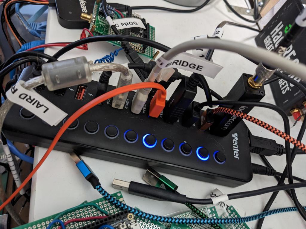

For me, this powered USB hub is invaluable.
Before I had this, I had a bunch of COM ports identified on my PC, and more than once I've overwritten the wrong firmware because I got confused.
With this hub, I can switch off all of the devices I'm not using. And just enable the one or two that I want. As you can see, I tried labelling the USB cables - but that was a bit of a pain - so then I went for multi-coloured USB cables. That makes everything very easy. Highly recommended if you're dealing with firmware.
https://www.amazon.ca/gp/product/B095Y5R8HD/ref=ppx_yo_dt_b_search_asin_title?ie=UTF8&psc=1

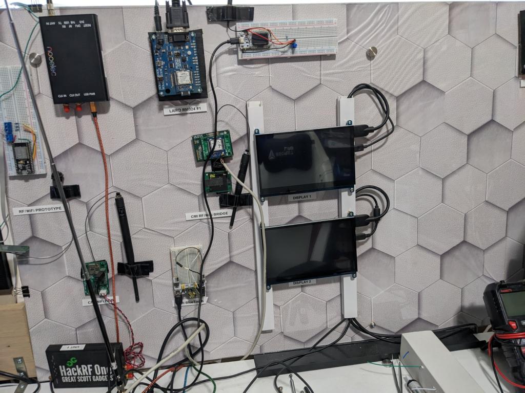

On a similar note, I have a bunch of prototype boards for customers that end up getting lost on my table. So I got a 4'x2' bit of thin plywood, put some cheap backing tape on it to make it look pretty then put a bit of 4'x2' plexiglass over the front - and mounted it vertically. Now I use velcro tape to stick up any customer boards that I don't want damaged. With the coloured USB cables, it makes it very easy to switch these on and off from the USB hub.
When I no longer need to deal with a board, the velcro tape peels off cleanly, leaving space for future projects.

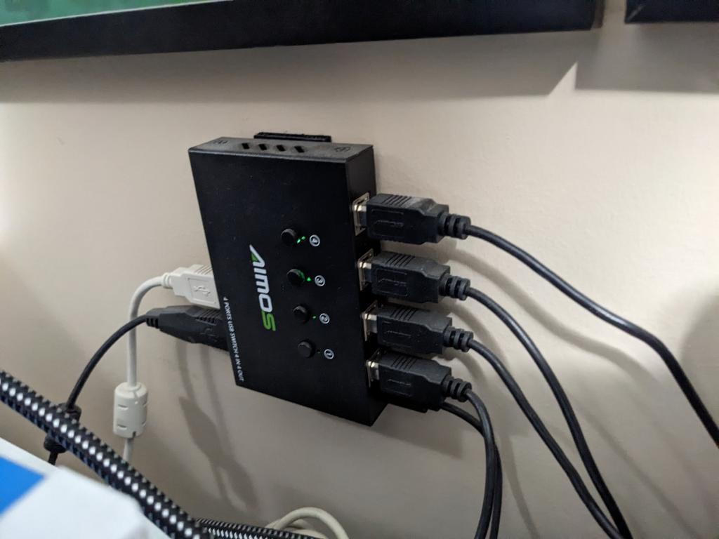

And the final life saver (apart from the big giant pack of anti-arthritis pills I have on the desk), is this wee doo-hicky (below).
https://www.amazon.ca/gp/product/B08GKGKG3J/ref=ppx_yo_dt_b_search_asin_title?ie=UTF8&psc=1
It's a USB KVM, which allows me to use the one mouse and keyboard with multiple computers. I have it hooked up to my main PC, my Mac (I hate the Mac - but need one for compiling iPhone programs), and a couple of Raspberry Pi's. Unfortunately it doesn't work with the CMM2   So I still need a separate keyboard for that.
