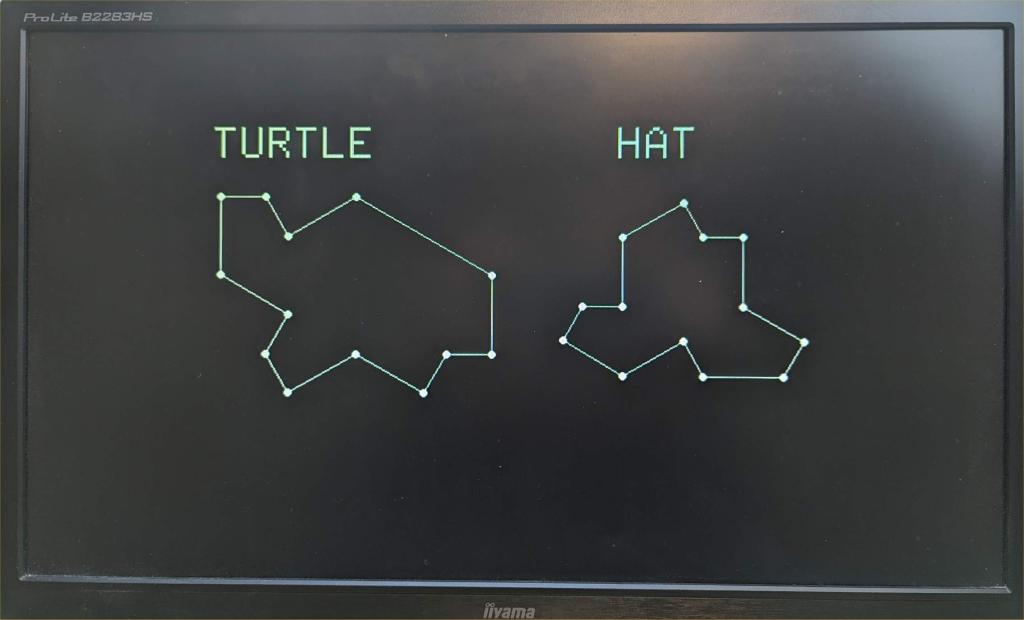

If you have been reading the press  you will know about the discovery of aperiodic monotiles.
This little program plots the two forms that have been discovered using the coordinates given here
Dim r(1)=(1,0)
Dim d(1)=(Cos(Rad(60)),-Sin(Rad(60)))
Dim u(1)=(Cos(Rad(60)),Sin(Rad(60)))
Dim c(1),e(1),f(1)
Dim xy(1,12)
CLS
hat
Math scale xy(),MM.HRes/9,xy()
For i=0 To 11
 Line xy(0,i)+MM.HRes*.6,MM.VRes\2-xy(1,i),xy(0,i+1)+MM.HRes*.6,MM.VRes\2-xy(1,i+1)
 Circle xy(0,i)+MM.HRes*.6,MM.VRes\2-xy(1,i),3,,,RGB(white),RGB(white)
 Pause 1000
Next
 Circle xy(0,12)+MM.HRes*.6,MM.VRes\2-xy(1,12),3,,,RGB(white),RGB(white)
 Line xy(0,12)+MM.HRes*.6,MM.VRes\2-xy(1,12),xy(0,0)+MM.HRes*.6,  MM.VRes\2-xy(1,0)
Text MM.HRes*0.7,MM.VRes/6,"HAT",C,,MM.HRes/200
Pause 1000
turtle
Math scale xy(),MM.HRes/16,xy()
For i=0 To 11
 Line xy(0,i)+MM.HRes*.1,MM.VRes*.3-xy(1,i),xy(0,i+1)+MM.HRes*.1,MM.VRes*.3-xy(1,i+1)
 Circle xy(0,i)+MM.HRes*.1,MM.VRes*.3-xy(1,i),3,,,RGB(white),RGB(white)
 Pause 1000
Next
 Circle xy(0,12)+MM.HRes*.1,MM.VRes*.3-xy(1,12),3,,,RGB(white),RGB(white)
 Line xy(0,12)+MM.HRes*.1,MM.VRes*.3-xy(1,12),xy(0,0)+MM.HRes*.1,MM.VRes*.3-xy(1,0)
Math scale xy(),40,xy()
Text MM.HRes*0.2,MM.VRes/6,"TURTLE",C,,MM.HRes/200
Do :Loop

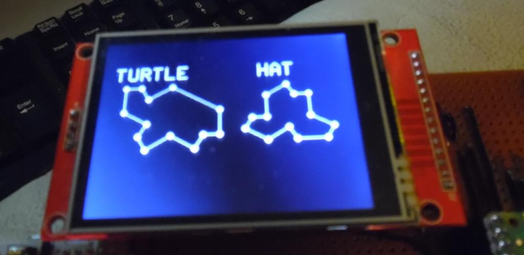

Your code works pasted into mmedit and ili9341 but what to do??
