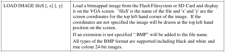

I may need a little more information regarding the format that a BMP file needs to be in to be displayed correctly by the LOAD IMAGE command.
I have a 16 colour indexed BMP file that I created in the GIMP (using the palette that was discussed in another thread) and when I load it using LOAD IMAGE, all I get is the black portions of the image displayed in green (though in reality, probably myrtle).
The original image is larger than the display, I am in Mode 2, should that matter?

The good news is that I found out how to fix my problem.  I re-saved my indexed BMP file as an RGB format BMP file and it loaded exactly as expected.
So sorry @geoffg and @matherp, I'm not sure if it's a bug, or a feature, but unfortunately the statement in the manual that LOAD IMAGE supports all formats of BMP files doesn't seem to be the case.  So it's either a change in code or a change in the manual.  No guesses which is easier.

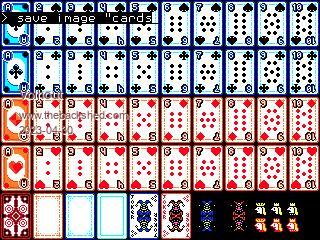

Posts: 3416
Posted: 09:05am 29 Apr 2023
That displays correctly on my VGA.

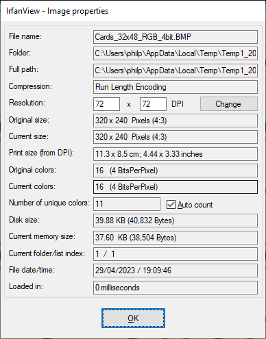

Used
save compressed image "Cards_32x48_RGB_4bit.BMP"
Cards_32x48_RGB_4bit.zip
Now it's 40kB

Posts: 3416
Posted: 11:05am 29 Apr 2023
IrfanView and Paint can display it ok but black & green on the pico.
The size is too big, 416 x 240 pixels. 320 x 240 max.
For processing your 24 bit images put them on a SD card and use the PicoVGA 'Save Image' to convert them to 4 bit. 'Save Compressed Image' uses run length encoding to shrink them further.
