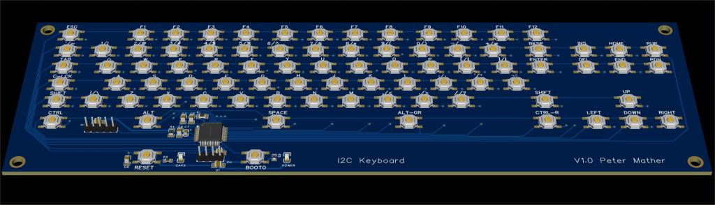

Posts: 12058
Posted: 09:49pm 10 Apr 2023
GBP 18 fully built by JLC. Just need to write the code for the STM32.
210.82 mm * 66.04 mm

ROFLOL, you're a "dangerous" man Peter.
The price is about twice what I originally paid for my M5Stack i2c keyboards, though it is also bigger; is that STM32 semi-unobtainium ? Could an RP2040 (running MMBasic ?) do the job. Or am I making sh*t up because I'm too ignorant to know better ?

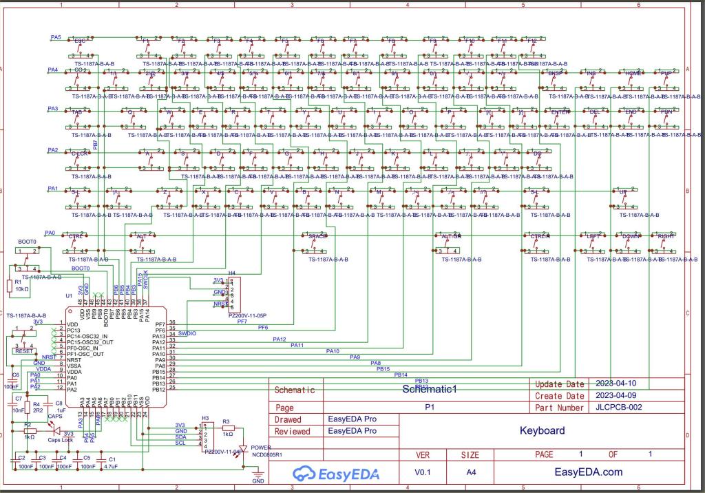

Posts: 12058
Posted: 07:04am 11 Apr 2023
  Quote  is that STM32 semi-unobtainium ?
No, it is chosen because it is in stock at JLC and a "basic" part so minimum cost.
All the parts are "basic" for cost reasons
The GBP price of 36 for 2-off and includes shipping and VAT
The actual cost per board is just under GBP9
I intend to design a 3D printable overlay to turn it into a "real" keyboard
The problem with netbook keyboards is that there are no pinouts available, the pinout is probably not standardised, and they need a undefined FPC connector before you can even start to try and buzz them out to connect to a uP. After all that you can start to think about how to mount them in a usable way
Posts: 9238
Posted: 07:40am 11 Apr 2023
I like. :)
I like the two spiky sticky up finger piercers at the LH end too.  ;) (swap them for right-angle ones?)
I can see the 3D printer owners being in demand: "Hey, ..., How do you fancy swapping one of your keyboard overlays for one of my ready built keyboard PCBs?". :)
Posts: 12058
Posted: 08:04am 11 Apr 2023
The headers were just to create the holes in the PCB. The 5-pin one is the ICSP header for debug/development. The 4-pin is the actual I2C and could be right angle on the bottom or flying lead - whatever

1. the pinouts are DEFINITELY not standardized across different models, hence why you would need to first obtain a sample of the model you intend to use and buzz it out. this is not exactly rocket science, they are just a simple matrix with no components integrated into them. as i said before, the NAV51 keyboards have been around for OVER A DECADE and are still obtainable.
2. the FPC connectors come in about three different pitches. in a 'home built' environment you only need the right pitch and AT LEAST enough pins - it is easy enough to insert the FPC hard up against the pin 1 end of the connector and ignore the space left at the other end. in no way practical on a production line, but fine for 'home built'. use the 'lever locking' connectors, these are both ubiquitous and cheap.
3. mounting the keyboard is absolutely trivial! pick your housing, cut a rectangular hole in the top, and sit the keyboard in the hole. use a chunk of flat wood or similar solid material behind the keyboard to prevent it flexing. there is nothing simpler to mount, other than perhaps one of those self-adhesive 4x4 keyboards that you stick to a flat surface. the NAV51 is rectangular, obviously avoid any model that has a non-rectangular shape.
these keyboards date from an era when they were designed to clip into a 'tray' opening  in laptop, from the OUTSIDE. often memory upgrades and sometimes access to the HDD was via removing the keyboard, just like lifting the lid on a biscuit tin.
4. software-wise, as the keyboard is JUST a simple matrix, you could likely write the software in such a way they you don't even need to buzz out the keyboard first, but have the software interactively 'learn' the key placements through a configuration program that the user runs. instructions like "press Q to P keys in order" would suffice to map out most of the keys.

Posts: 117
Posted: 07:36pm 11 Apr 2023
@matherp
Nice KB Peter, you are one hell of a machine!
My preference would have been to have the RESET and BOOTTO buttons at the top of the KB, perhaps on the right side. Just a thought.
