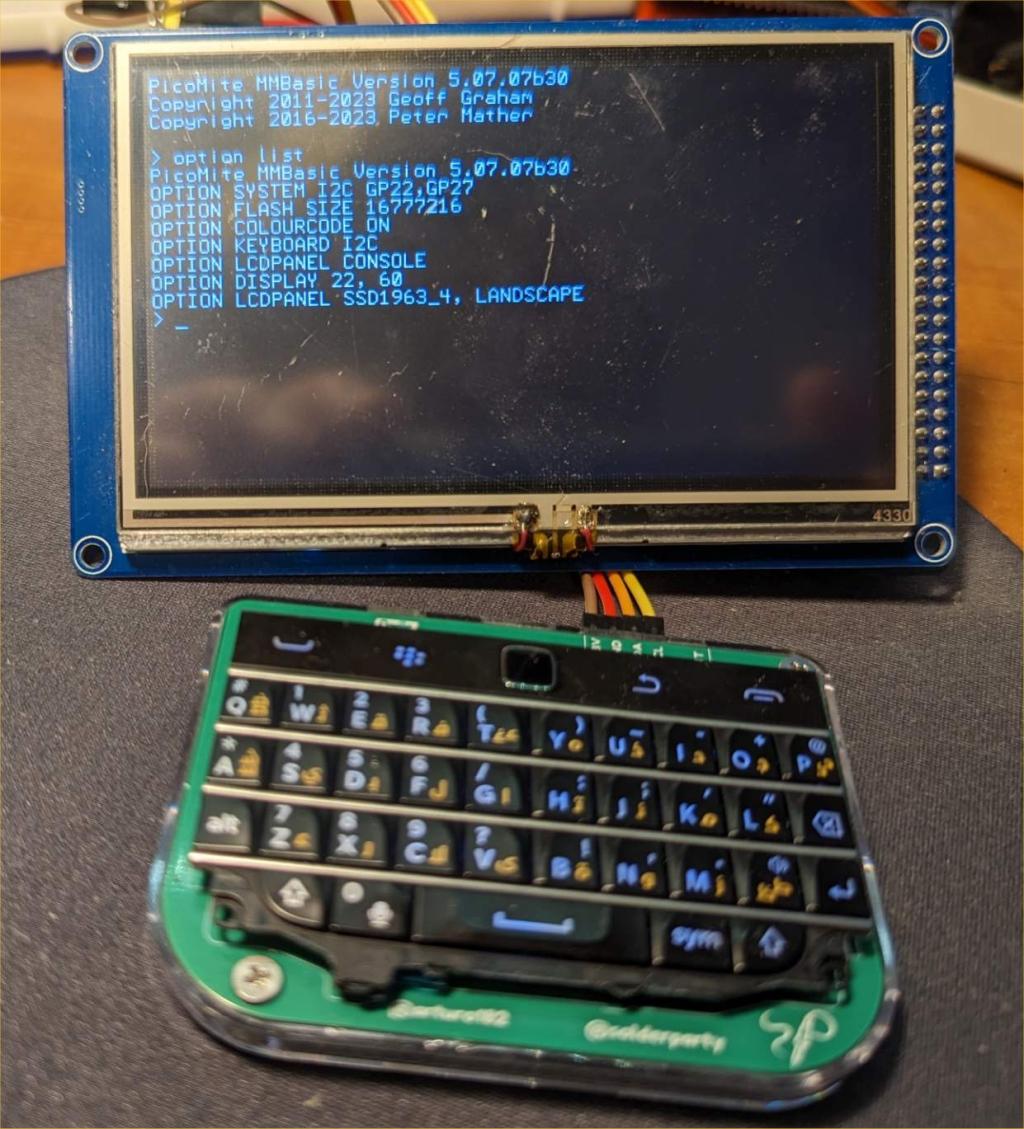

Posted: 06:56pm 30 Mar 2023
https://youtu.be/2GXYNO6PT4A
4.3" SSD1963 display 480x272

Hehe cool!
Yep, it is from a Blackberry mobile phone. One can get those bare keypads for about 2€ and build it around an own microcontroller. This already presoldered board is a bit pricy for me.
But a great idea for a small on the go device indeed.

It seem to be a bbq20 , i have made test on the bbq 10 that is smaller without the mouse pad

If I'm not mistaken you are missing the point, and Peter is being coy, that is a mini I2C keyboard connected at the firmware console level to a PicoMite, he has just created a hand-held boot to MMBasic device.

I believe you are correct, Tom. OPTION KEYBOARD I2C is nice! :)
And a 4" SSD1963 parallel LCD.

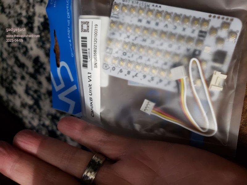

I found this online at RobotShop. I will get a chance to try it in a couple days after the Easter Meal in over. Is cheap and I2C so , what the heck. Worth a try.

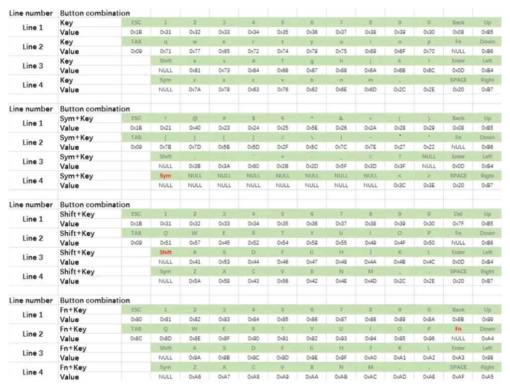

Found this to go with it:-

I have two of these M5Stack i2c keyboards in my stash too. The keys are just tac switches so pretty nasty to use.
Obviously it would be great if the PicoMite supported them, it would save me having to try to do it myself when the time comes, but after a quick Google I believe this product may be end-of-life.
