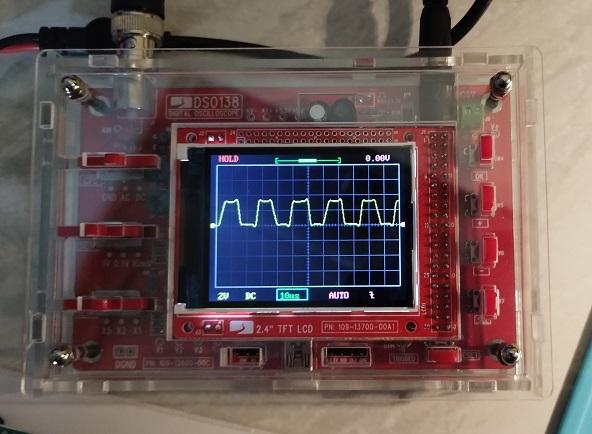

In relation to the speaker thread I'm just poking around with my oscilloscope and found this signal on GP6 (and GP7) even without running any program on the PicoMite - is this expected even when the sound is quiescent ?
OPTION AUDIO GP6, GP7
I wouldn't put much faith in the shape of the trace (only its existence) as I'm still using a POS scope with POS probes - the management vetoed my "spending" on a proper one (because I wouldn't use it, and TBH this is the first time I've used my scope in 4 months), but has ackowledged that my upcoming 50th birthday will trump this .

Yes. This is a 50/50 output that generates a steady 3.3V/2 output voltage allowing the wave to swing either side
Posts: 6626
Posted: 10:38am 26 Mar 2023
A square wave of 50% duty cycle will give you a voltage of 3.3 / 2 after filtering.
So, yes, what you see is correct.

OK, thanks.

Direct Digital Synthesis (DDS) signal generation is a technique used in electronics to generate waveforms of different frequencies and shapes. It is based on the precise control of a digital oscillator, which can produce a highly stable and accurate output signal.
There are three main components involved in DDS signal generation:
   A digital signal processor (DSP) or microcontroller, which performs the necessary computations to generate the waveform.
   A digital-to-analog converter (DAC), which converts the digital signal into an analog voltage.
   A low-pass filter (LPF), which smooths out the output signal by removing high-frequency noise and harmonics.
The DDS technique involves two main steps:
   A phase accumulator generates a digital representation of the waveform's phase. This value is updated every clock cycle, causing the phase to advance continuously.
   A lookup table, or waveform table, stores the desired waveform at various phase increments. The DSP reads from this table and outputs the corresponding voltage for each phase value.
In the case of the PicoMite the digital-to-analog converter is created by modifying the duty cycle of a 44100Hz square wave
By controlling the frequency and amplitude of the output waveform, DDS signal generation can be used in a wide range of applications, such as audio synthesis, signal modulation, and test and measurement equipment. As it is a digital technique, it is highly flexible and can be easily programmed to generate complex waveforms with precise timing and frequency control.
Edited 2023-03-26 20:51 by matherp
Posts: 4405
Posted: 10:55am 26 Mar 2023
Thanks Peter, I knew some of this at a very vague level and I appreciate the extra effort to educate me.
My query was specifically with regards to whether the signal was expected when MMBasic was not actually requesting any sound be played, I now understand that it is - it is sufficient for OPTION AUDIO to be configured even if not used.
