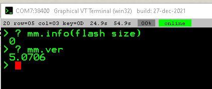

A stupid question: what does mm.info(flash size)?
When I type print mm.info(flash size) it returns 0
I know it would report the size of flash memory, but what memory?
I use the 5.07..07b28 version.
Did I discover a new bug or is the flash memory an optional thing?
The flash slots do work and the A: drive also.

Yeah, I am getting that also.

mm.info(flash) returns the flash slot currently running a program - normally 0
mm.info(option flash size) returns the size of the flash memory chip

  matherp said  mm.info(flash) returns the flash slot currently running a program - normally 0
Thanks... so it becomes the time that the manual has to be updated, because a lot has changed.
