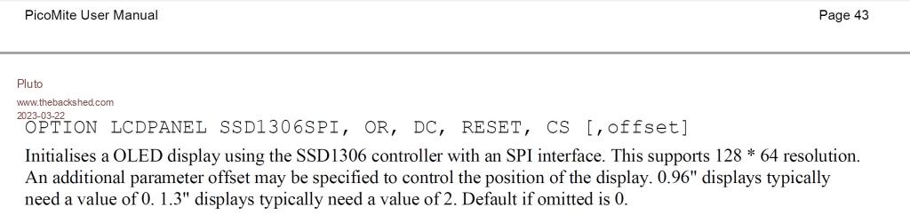

Yes you have to connect all. See the p.44 in PicoMite User Manual MMBasic Ver 5.07.06 (if you are using PicoMite).

Pluto
Joined: 09/06/2017
Location: Finland
Posts: 411
Posted: 04:23pm 21 Mar 2023
Pluto
Joined: 09/06/2017
Location: Finland
Posts: 411
Posted: 04:28pm 21 Mar 2023
