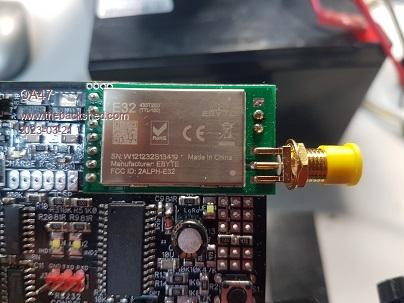

I have been using the Ebyte E32 433Mhz LoRa module for a number of years to enable the Micromites to communicate with each other. Like these ones:

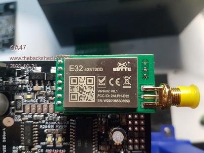

As I wanted to extend the current network of units, I ordered another quantity of units like these:
I then spent a large amount of time chasing transmission faults and banging my head against the 'shed ' wall. In the end I contacted the manufacturer and here is parts of their reply:
  Quote  Now the models are V8 version . If your old orders are bought long time ago. They can not communicate .
  Quote  Sorry We don't sell the old versions
I have put up this post in the hope another shedder does not get caught with this scenario.

I went back and re-read the online ad for these units and it does say that they are Version 8 but does not indicate that they are incompatible to the Versions 1 thru 6. It is bad enough trying to avoid the clones these days for this type of situation but another to find out after the purchase from the manufacturer.
