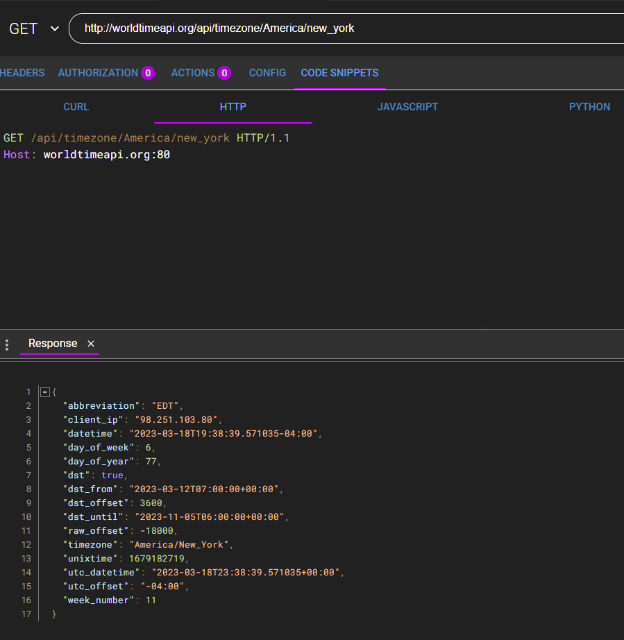

WorldTimeAPI is a simple web service that returns the current local time for a given timezone as either plain text or JSON.
curl
"http://worldtimeapi.org/api/timezone/America/New_York"
And my code is as close to the SAMPLE code as possible for "reasons".

Ok well... That *does* trim out the header... (Which was where I was headed with this...  so Thanks)
It seems ODD that the header gets captured on the GET REQUEST made by MMBASIC, but not on a CURL or an "Advanced Rest Client" request. (or are we SUPPOSED to capture header data in the GET request?)
I thought this would be a simple client API call example to add to my docs... but it quickly became troublesome.  Anyway... JSON$ is happy now as the BUFF%() array now does only have JSON data in it.
