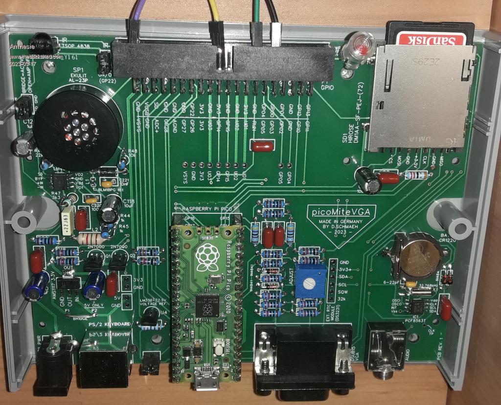

This ticking is pretty normal (if we are speaking about the same phenomenon). I've noticed this often on cheap PAM8403, too. Does it really come from the Pico? Are you supply the voltage via USB? Often USB is bleeding some harmonics into the audible range, thats why I ALWAYS use ferrite beads and form a lowpass in the Mhz range to avoid this.
Also some points about audio in general:
If I hear via headphones (no amplifier) on the normal picMite audio the audio is fine, but if I go into a PAM8403 there is A LOT of digital noise audible, including some harmonics of the carrier frequency. This has also something to do with the signal before it hits the (power)amplifier input. I would avoid those cheap chineese modules.
I don't even use Volhout filter design but the "original" one and have no problems with the mentioned lowpass filter in the Mhz range (usb noise) and feeding the signal into the LM4871M (datasheet example) circuit driving an 8 ohm load / speaker. This chip can output 3W and is really loud, even with this tiny speaker you can see:
Greetings

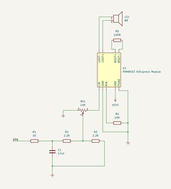

I'm still struggling with this, both with ticking and hissing when using PLAY SOUND:
   https://www.youtube.com/watch?v=4fvh2d3T42U
1. It's not the SD card, it sounds the same with and without the LCD/SD module attached.
2. There is more hissing when running from the battery than from the Pico/USB.
3. I can "hear" the heartbeat LED flashing as a hiss.
4. The output from PLAY WAV is acceptable, no ticking and not significant hissing.
I'm looking to remove/reduce the tick and the hiss, I realise the former may be something that if completely fixable will require me to improve the software, but I'm guessing the latter is a matter of scattering capacitors/resistors/ferrite beads like confetti .
And no I haven't done, or understood everything that has been suggested, I'm even more out of my depth with analog than I am with digital electronics.
Here is my current schematic:
The low-pass filter is the original PicoMite one, I've also tried the one in the more recent PicoMite manuals (4.7mH/2.7nF/33nF/68nF) on solderless breadboard and it didn't seem any better .
What I'm planning to try next:
1. Try a soldered version of the improved filter.
2. Put both a 100uF electrolytic and a 0.1uF between power and ground on the main PicoGAME LCD after the battery switch - which I think is what @Turbo46 is saying ?
3. Update my music engine to remove redundant calls to PLAY SOUND when two consecutive "notes" are the same.
Any other specific suggestions are welcome,
