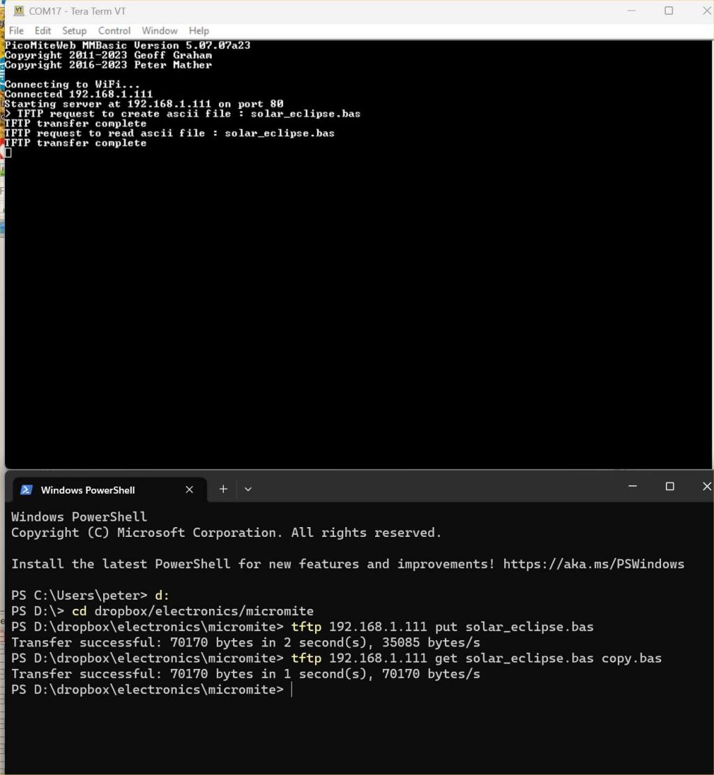

V5.07.07a24
PicoMiteWebV5.07.07a24.zip
Note the times taken and the file size
See here for how to enable TFTP on windows (tested on W11). Linux users: you are on your own
The TFTP server is automatically enabled if you are connected to wifi and makes transferring files easy and fast. NB: The protocol TFTP does not support directory listing etc. so don't ask. It is also completely insecure so only use on your local network.
  Quote   tftp
Transfers files to and from a remote computer running the TFTP service.
TFTP [-i] host [GET | PUT] source [destination]
 -i              Specifies binary image transfer mode (also called
                 octet). In binary image mode the file is moved
                 literally, byte by byte. Use this mode when
                 transferring binary files.
 host            Specifies the local or remote host.
 GET             Transfers the file destination on the remote host to
                 the file source on the local host.
 PUT             Transfers the file source on the local host to
                 the file destination on the remote host.
 source          Specifies the file to transfer.
 destination     Specifies where to transfer the file.

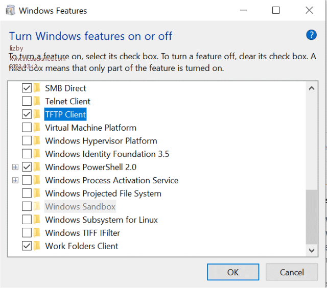

  TassyJim said  Works from Windows 11 after enabling tftp client in apps and featuresJim
Thanks for that. I struggled with the installation of the SolarWinds TFTP server. It ran through most of the steps, then said the installation had failed. I ran it again, and it asked if I wanted to Repair or Remove. I chose Repair, but TFTP from the PowerShell didn't work. I uninstalled and repeated: again failed, again repaired.
Now with Jim's suggestion, after searching for Windows Features, I went here:
Clicked TFTP Client and OK, and now it works. Great improvement in speed of transfer and ease of use.
Posts: 12058
Posted: 02:04pm 13 Mar 2023
Just to be clear to anyone else.
You need to install a TFTP client and not a server to use the new functionality. The link I provided explains both and I should have made it clear that only the client is needed and in windows that is just a matter of enabling it.
