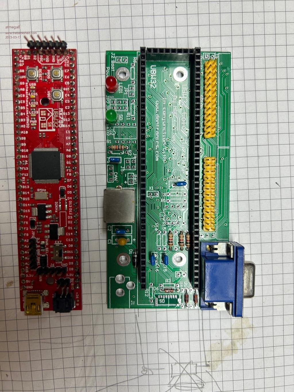

I also found this baseboard from ( Dontronics?) and now it’s Time to bring this Combo back to life.
Another wonderful Mmbasic Device.

With support from Brian Schmalz, THANK YOU BRIAN,
i was able to flash the bootloader.
And with the correct Bootloader
http://www.schmalzhaus.com/UBW32/FW/HIDBoot.X/dist/MX795/production/HIDBoot.X.production.hex
i can flash mmbasic or whatever i want.
