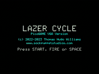

Posts: 6197
Posted: 09:57am 17 Apr 2023
@Tom,
Downloaded the PMVGA version, try to run on Peters VGA board using keyboard (no controllers (or pullup resistors), just floating GP pins) and the game is stuck on the startup screen (pressing "SPACE" won't start it).
Any part of the code I can adapt to make it run.
PicoMite 5.07.07RC4
Edited 2023-04-17 19:59 by Volhout
Posts: 4405
Posted: 10:10am 17 Apr 2023
Hmm, I wonder if the floating pins give the controller detection code apoplexy, that would be a bl**dy nuisance, the only VGA boards I have to test with are PicoGAMEs.
EDIT: Though if that were the case I'd just expect it to start with some random controller rather than not start at all. I don't suppose a non-UK keyboard returns a different PS/2 scan-code for space ... seems unlikely.
There is a piece of code that looks like:
controller_data_pmvga:
Data 10, 5
Data "KEYS: CURSOR", "keys_cursor", 1
Data "KEYS: AZ,.",   "keys_cegg",   0
Data "KEYS: AZXC",   "keys_azxc",   0
Data "KEYS: '/,.",   "keys_punc",   0
Data "GAMEPAD A",    "nes_a",       1
Data "GAMEPAD B",    "nes_b",       1
Data "JOYSTICK A",   "atari_a",     1
Data "JOYSTICK B",   "atari_b",     1
Data "AI",           "ai_control",  0
Data "NONE",         "no_control",  0
Try replacing it with:
Data 6, 1
Edited 2023-04-17 20:14 by thwill
Posts: 6197
Posted: 10:25am 17 Apr 2023
Yip,
That did it. Now the game starts.
Let's play....
It's fun....
EDIT: debugging
enabling GamePad: Error message "Setpin: GP15 already defined (is RTC I2C bus)).
enabling Joystick: This causes the startup screen not to proceed when pressing "SPACE".
Edited 2023-04-17 20:37 by Volhout
Posts: 4405
Posted: 10:50am 17 Apr 2023
  Volhout said  enabling GamePad: Error message "Setpin: GP15 already defined (is RTC I2C bus)).
Are you sure ? GP15 isn't I/O for the GamePad, though it is the fire-button for Atari Joystick B.
EDIT: The RTC connected to the fire-button of Joystick B is probably the problem, the code polling that Joystick waits for the fire-button to be "released" and I'm guessing that never happens - does the RTC hold GP15 up ? ... Hmm, my code doesn't configure the Atari inputs as pull-up on the PMVGA either, perhaps it should.
Edited 2023-04-17 21:00 by thwill
Posts: 6197
Posted: 11:56am 17 Apr 2023
Sorry Tom...
enabling was the wrong word. "commented out" should be the wording.
Yes, ATARI caused the SETPIN error on GP15
Posts: 9238
Posted: 12:03pm 17 Apr 2023
The PicoGAME boards use GP26 and GP27 as I2C pins for the RTC. Obviously, you can't have an analogue joystick using them at the same time.
GP14 and GP15 are used for FIRE inputs, but are also the supply pins for NES controllers, in which case they are fed via 150R resistors. They shouldn't really be used as outputs as there's a danger of shorting them with a FIRE button.
Edited 2023-04-17 22:03 by Mixtel90
