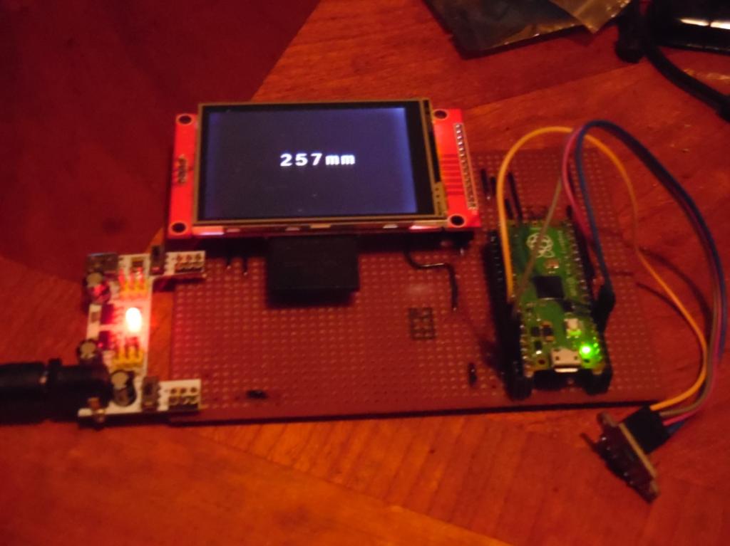

Joined: 25/06/2022
Posts: 2807
Posted: 11:40pm 06 Mar 2023
  matherp said  The manuals are trivial to understand with respect to I2C IFF you take the trouble to understand I2C first. It is not and cannot ever be the role of a MMBasic manual to explain the intricacies of I2C, SPI, UARTs etc
Appendix B of the manual has a great deal of information about using I2C including an example.
It took me less than 5 minutes to create the working, tested code above
Your code works on ili9341 lcd. Thanks. Seems you have the vl53lox. I like it more than ultrasonic range finders for robot avoid obstacles. Your code as an example in the manual for others maybe.
I added a space for the display or it left chars on the display
Text MM.HRes/2,MM.VRes/2, " "+Str$(Str2bin(uint16,d$,BIG),3,0)+"mm",cm
