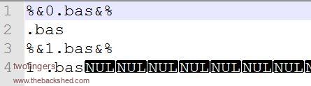

Hi Peter,
that's weird!
Open "testprint.txt" For output As #1
   Print #1,"%&"+"0.bas"+"&%"
   Print #1,"0.bas"
   Print #1,"%&"+"1.bas"+"&%"
   Print #1,"1.bas"
Close #1
I get this with edit:
  Quote  %&0.bas&%
.bas
%&1.bas&%
1 .bas
> list"testprint.txt"
%&0.bas&%
0.bas
%&1.bas&%
1.bas
With Notepad++ (Windows)
At the moment I have no way of connecting an SD card. I just wanted you to be informed. There is a workaround, but it's not very elegant.

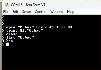

Posts: 12045
Posted: 04:25pm 01 Mar 2023
Your notepad version has been transferred with Xmodem from it loaded as a program
Use XMODEM S "testprint.txt" and it should be the same as LIST
The problem is that when you load it and edit it the file is tokenised with undefined  results
LIST just prints the ascii so is correct

twofingers
Joined: 02/06/2014
Posts: 1782
Posted: 04:47pm 01 Mar 2023
  matherp said  Your notepad version has been transferred with Xmodem from it loaded as a program
Hi Peter, your assumption is correct. It's not a bug. Sorry! Learned something again ...
