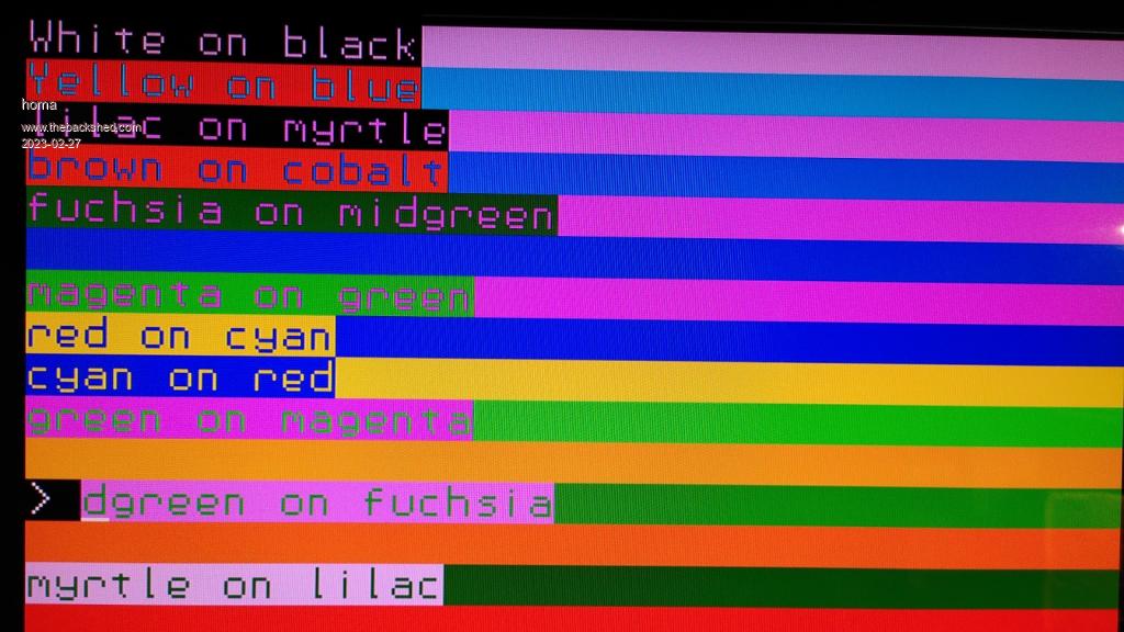

It also enables the PRINT and TEXT commands to use colour as long as the character locations meet the conditions above.
So, in mode 1, you can now go
TEXT 0,0,"Hello World",,,,rgb(red),rgb(green)
or
colour rgb(red),rgb(green)
print @(0,0)"Hello world again"
and it will do what you expect (in mono mode   )
If the output is not aligned to a tile boundary then the tile colours will be
ignored. So print @(100,0)"Hello world" will appear in whatever the tiles on which it is written are set to (typically black and white)

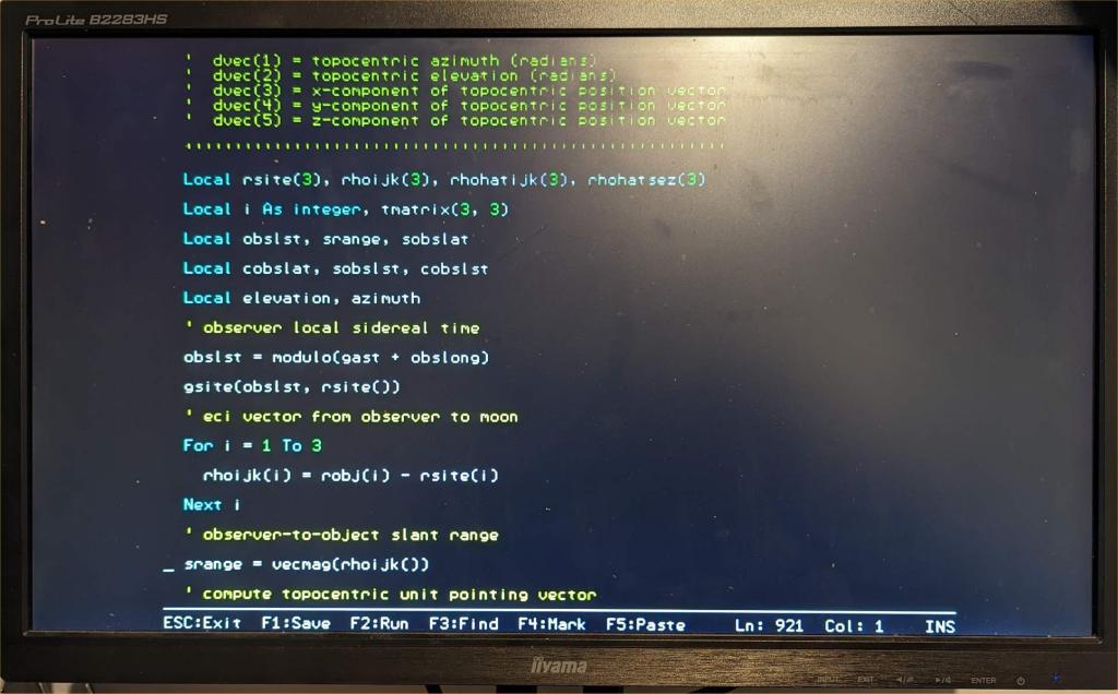

To use the editor in colour then, of course, you need to set OPTION COLOURCODE ON

Edit with Colorcode looks Nice, Peter..
but ..
I just discovered a small imperfection..
1. in the editor (mode 1 or 2, color code on or off)
when you move the Cursor from bottom to top and it starts scrolling, the content disappears, except for the top line.
2. If you start editing a Line, everything below this Line disappears
This effect is independend of TILE SMALL or LARGE
Cheers Mart!n

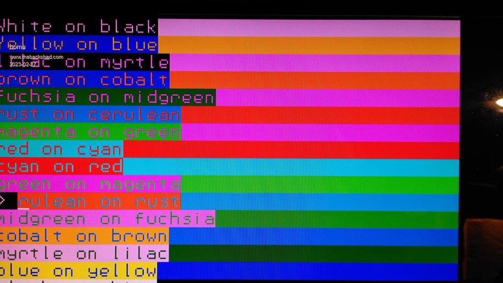

When Tile set to small, cls RGB(white) does not clear the whole screen.
(also in the new/Updated Version)
to the New version..
1. after booting, VGA Screen stays Black, the prompt appears after you do a CLS
2. as I wrote above, CLS color doesn't work right when small Tilesize is on
3. Colourcode doesn't appear in Edit (Mode 1)..
4. when Tiels set to Small, mysterious Holes in the Listing in Edit mode (Tiles seem to be Black on Black) at the same Place, where the errors at CLS appears.

  Quote  1. after booting, VGA Screen stays Black, the prompt appears after you do a CLS
Not for me. It appears after a reset, power on or software reset.
  Quote  When Tile set to small, cls RGB(white) does not clear the whole screen.
  Quote  as I wrote above, CLS color doesn't work right when small Tilesize is on
Again, does for me. If you have a sequence that causes the fault I need the complete sequence. You can create the problem by setting tiles. Use TILE RESET to clean things up
  Quote  Colourcode doesn't appear in Edit (Mode 1)..
Explain please
  Quote   when Tiels set to Small, mysterious Holes in the Listing in Edit mode (Tiles seem to be Black on Black) at the same Place, where the errors at CLS appears.
Please try again with OPTION CPUSPEED 252000. Sounds like your Pico maybe isn't completing the interrupt routine in time. I'm not seeing any faults like you describe
Also use auto-adjust on your monitor
Edited 2023-02-17 02:14 by matherp

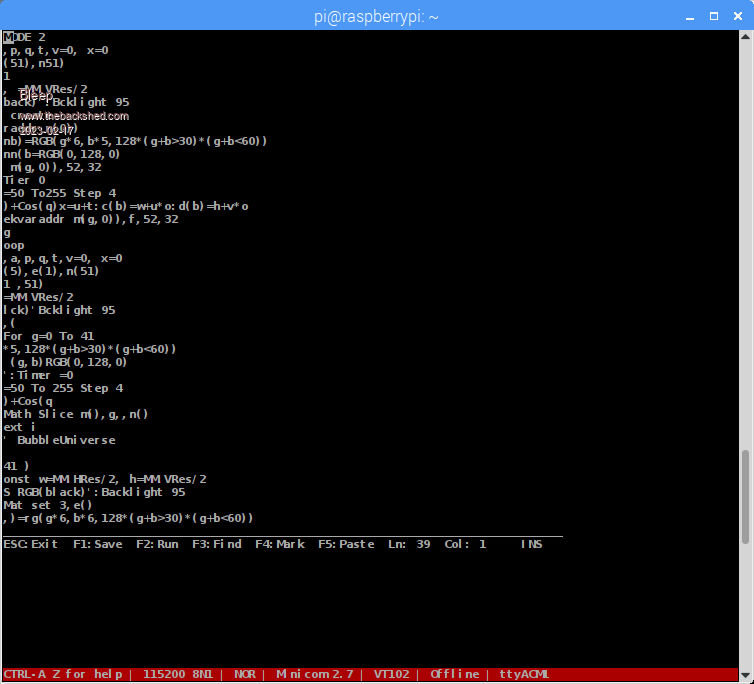

I have a problem when using the editor in mode 1.
If I change to Mode 1 and then Edit, the editor only shows some of the lines of the program and locks up solid, requiring a power off reset.
PicoMiteVGA MMBasic Version 5.07.07b19
OPTION SYSTEM I2C GP22,GP15
OPTION KEYBOARD UK
OPTION DEFAULT MODE 2
OPTION DISPLAY 30, 53
OPTION SDCARD GP5, GP2, GP3, GP4
OPTION AUDIO GP6,GP7, ON PWM CHANNEL 3
OPTION RTC AUTO ENABLE
OPTION DEFAULT FONT 7, 1
I have now found that it's the OPTION DEFAULT MODE 2 that is causing this, if I change it to OPTION DEFAULT MODE 1 all seems to be ok.
Edited 2023-02-17 05:40 by Bleep

Also, I accidentally copied and pasted all of this piece of code, using autosave.
vgabubble.bas.zip
I realise it's several slightly different versions of the same code, however once loaded the editor mangles it, the first 35 lines of code are fine and consist of a loop so the rest is never executed. However I didn't think the remainder should get corrupted like this, even though it shouldn't be there? the image is after scrolling down one page. I had done a flash erase and fresh install of b19 with no options set this is a terminal, but the VGA looks the same. This isn't particularly important as I shouldn't have done it! :-(
