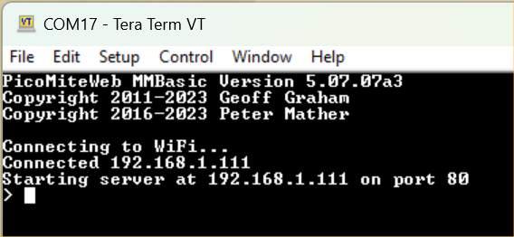

To connect to your WiFi router use the command
OPTION WIFI ssid$, password$
e.g. OPTION WIFI "myssid","myduffpassword"
The Pico will reboot and you should see it report connection and its IP address.

Again the Pico W will reboot and will report both the connection to the WiFi router and that a TCP server is now running

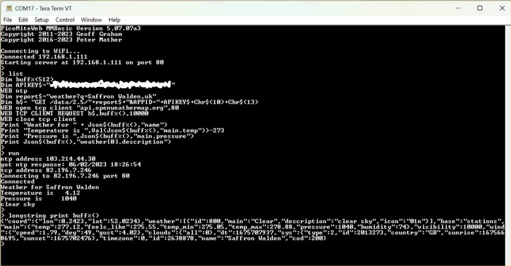

A full example application is given below - pretty simple. Note if you have used openweathermap before they have changed the interface and you may need to sign up for a new (free) account to get your APPID .
Dim buff%(512)
Dim APIKEY$="xxxxxxxxxxxxxxxxxxxxxxxxxxxxxxxxx"
WEB ntp
Dim report$="weather?q=Saffron Walden,uk"
Dim b$= "GET /data/2.5/"+report$+"&APPID="+APIKEY$+Chr$(10)+Chr$(13)
WEB open tcp client "api.openweathermap.org",80
WEB TCP CLIENT REQUEST b$,buff%(),10000
WEB close tcp client
Print "Weather for " + Json$(buff%(),"name")
Print "Temperature is ",Val(Json$(buff%(),"main.temp"))-273
Print "Pressure is ",Json$(buff%(),"main.pressure")
Print Json$(buff%(),"weather[0].description")

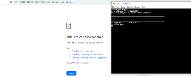

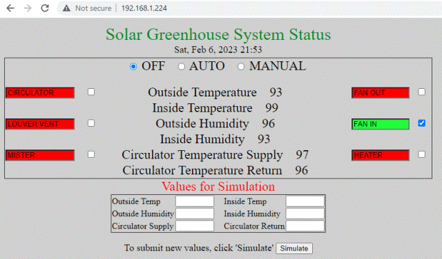

With a structure like the following, why am I getting a timeout?
initial:
 Dim buff%(512)
 WEB ntp -5
 initialize
main:
 do
   watchdog 60000 ' lb if not executed in 60 seconds, restart
   if sMinuteDigit <> mid$(time$,5,1) then newMinute
   if SIMULATE then poll
'    GetUserInputs  ' get inputs from local display
'    ReadSensors    ' get temperature and humidity
'    DisplayData
 loop
Sub poll
Local p%, t%, ii%, ss$
For ii%=1 To mm.info(max connections)
  LongString clear buff%()
  WEB tcp read ii%,buff%()
  p%=LInStr(buff%(),"GET")
  t%=LInStr(buff%(),"HTTP")
  If LLen(buff%()) Then Print "_________________________________________________"
  ss$=""
  If (p%<>0) And  (t%<>0) And (t%>p%) Then
    ss$=LGetStr$(buff%(),p%,t%-p%+4)
    Print "String is ",ss$
  EndIf
  If Instr(ss$,"small") Then
    Print "sending picture"
    WEB Transmit FILE ii%,"small.jpg","image/jpeg"
  ElseIf Instr(ss$,"favicon") Then
    Print "sending icon"
    WEB Transmit FILE ii%,"favicon.ico","image/vnd.microsoft.icon"
  ElseIf Instr(ss$,"HTTP") Then
    Print "sending page"
    WEB transmit page ii%,"gh.html" ' "gh.html"
  EndIf
Next ii%
End Sub

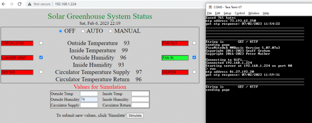

After some initialization, my main loop calls "poll". That successfully sends my page when I make the request in the browser. When I enter data and press the <Submit> button, my GET request is shown with "Print "String is ...". Then after a minute it times out. I had assumed that it would quickly do the 4 loops in "poll" and return to the main loop with the WATCHDOG 60000 statement.
What am I doing wrong with this structure?

Making some progress:
I'm not getting values returned when I check a box and enter a value and press [Simulate].  After a minute, I get a watchdog timeout. Some minutes later I get this on the browser line: http://192.168.1.224/G?Y=0&W=2&W=5&A=&B=&C=74&D=&E=&F=
(Which is expected.)
I'll try again removing the watchdog command.

poll must be called repeatedly and should not be contingent on anything. It is completely benign if no communication has occurred

I'm still stuck. I changed the original webserver.bas program to serve my html page, gh1.html:
Dim buff%(512)
Dim myfloat!=16.123
Dim myint%=999
Dim mystring$="The PicoMite Web is GO!!!"
WEB ntp -5
poll
Loop
Sub poll
Local p%, t%
For a%=1 To MM.Info(max connections)
WEB tcp read a%,buff%()
s$=""
  Print "String is ",s$
EndIf
If Instr(s$,"small") Then
  WEB Transmit FILE a%,"small.jpg","image/jpeg"
ElseIf Instr(s$,"favicon") Then
  WEB Transmit FILE a%,"favicon.ico","image/vnd.microsoft.icon"
ElseIf Instr(s$,"HTTP") Then
  WEB transmit page a%,"gh1.html" ' "test4.html"
EndIf
Next a%
End Sub
The page is served fine:
If I click the "LOUVER VENT" checkbox, put "74" in the "Outside Humidity" box, and press "Simulate", nothing happens for some time and then I get this:
There's never a response from the server, and MMBasic is locked up--I have to power cycle to get the ">" prompt. (In fact, the server is locked up immediately after it prints "sending page".)
Attached is the html file, "g1html.zip"--it contains gh1.html.
Any thoughts on what I should do?

I think I understand the issue but I'll start with a much simpler example and see what, if anything, needs to change

  Quote  Attached is the html file, "g1html.zip"--it contains gh1.html.
I can't see the attachment.
What browser are you using?
If you print out the full packet sent by your broqwser, it migh thelp see what's happening.
   longstring print buff%()' add this line.
