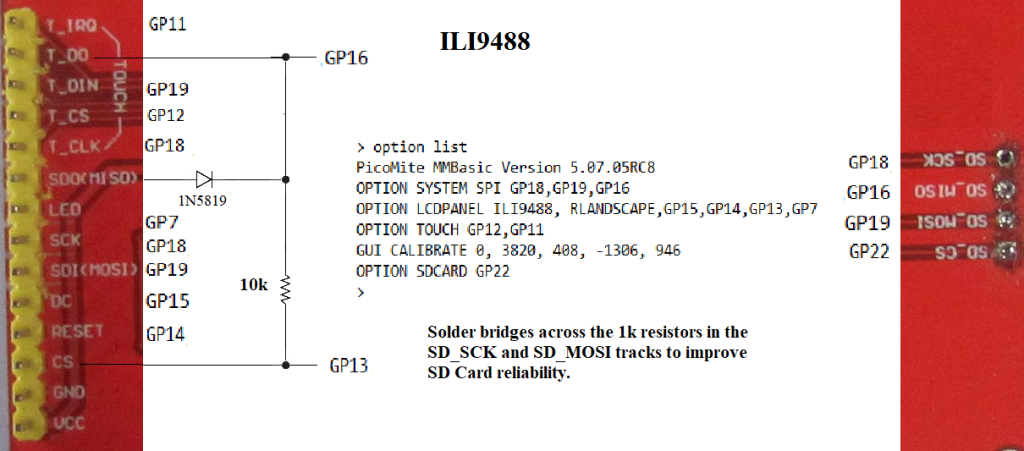

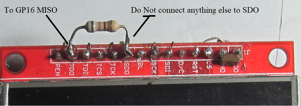

One way to add the 680R
That will allow touch and SD to share MISO on the Pico. If you find SD access is unreliable here is another method.

The 4" IPS ILI9488 is different to the panel above. The resistors near the SD socket are 4.7k pull-ups. R8 on SDO must be removed if the SD card is sharing SPI with the LCD panel. Otherwise the 10k (can be 4.7k to 10k) is unable to pass SDO to MISO.
You can use other diodes provided they have sufficient junction capacitance.
eg 1N400x series rectifiers work but 1N914 and 1N4148 don't unless you add 22pF to 150pF in parallel.

Thanks guys. Much clearer now. Thanks Phil for the marked up photos.

Definitely recommend the 10K + diode option

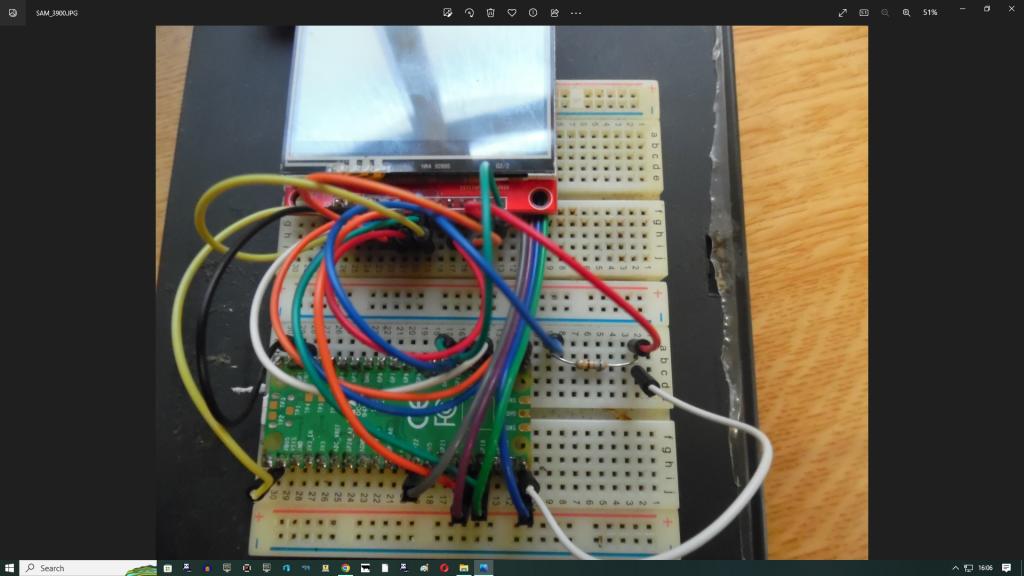

After help from this forum I used a 680R resistor then it worked.
