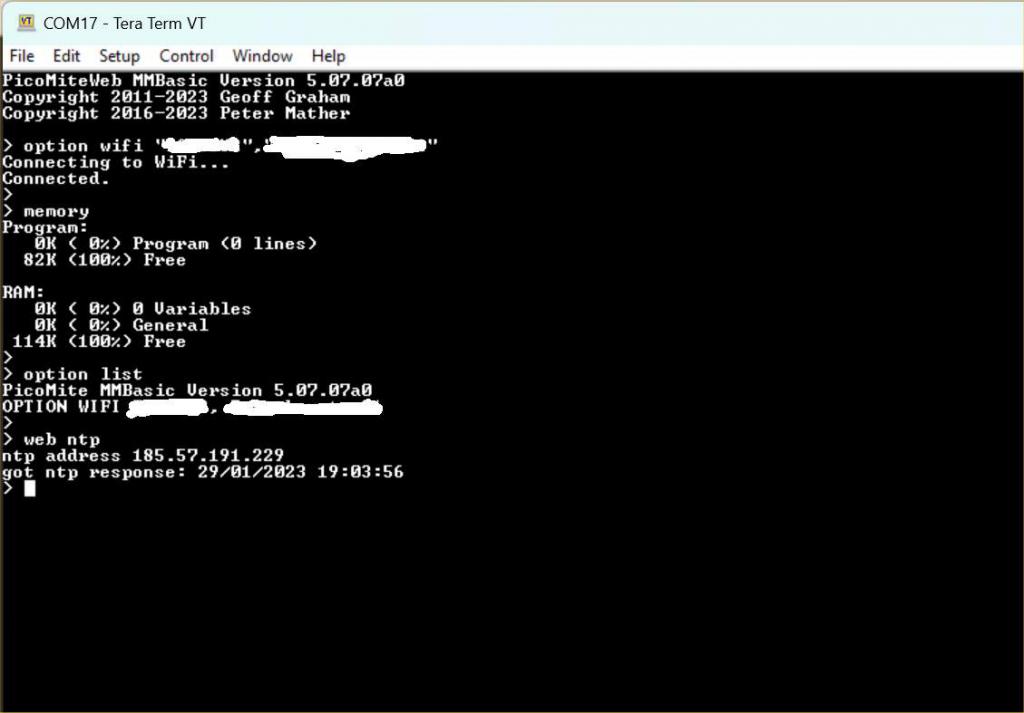

Posts: 6626
Posted: 09:12pm 29 Jan 2023
I knew I purchased a wifi module for a reason.
(too soon to ask but) Will the WEB NTP command get a timezone parameter?
> OPTION LIST
PicoMite MMBasic Version 5.07.07a0
OPTION WIFI someplace, not_telling
> web ntp
ntp address 88.198.226.248
got ntp response: 29/01/2023 21:12:54
> print time$
21:13:25

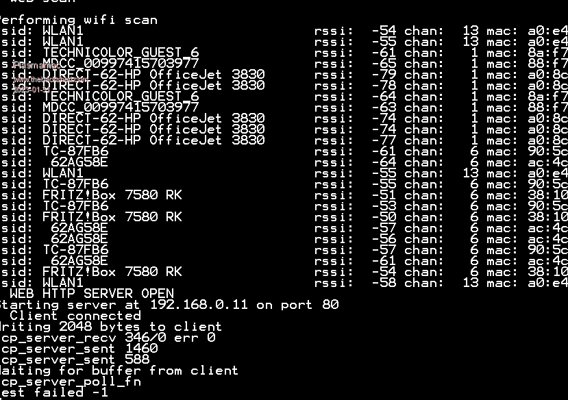

Posts: 12058
Posted: 10:14am 30 Jan 2023
V5.07.07a1
PicoMiteWeb.zip
WEB NTP [adjust]
The optional parameter 'adjust' is a float between -12.0 and +14.0 and allows you to offset the time given by the NTP server to suit your timezone
WEB SCAN
Scans for wifi access points in the vicinity
NB: forgot to mention in the first post GP23, GP24, GP25, GP29 are now completely inaccessible from MMBasic as they are used by the pico_w to communicate with the cyw43. The LED on the pico_w is actually driven by an IO port on the cyw43.
You can also try
WEB HTTP SERVER OPEN. This will create an HTTP server on the pico_w on port 80 (NB: not HTTPS). Doesn't do anything at the moment but you can connect to it from a browser and you will see the diagnostics. You will need to reset the pico_w to get out of it.

Plasmamac
Joined: 31/01/2019
Posts: 620
Posted: 03:35pm 30 Jan 2023
multiple listed some ssid , sry
