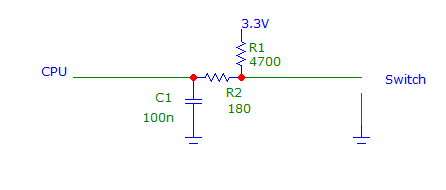

New problem, I bought a new rain sensor (tipping bucket) that used a reed switch, I modified the old sensor to use a photo interrupt.
I did not want to modify the new one but the reed switch is bouncing, is there an easy fix for this.

I put a 100nF capacitor on the input. It also helps stop nasties getting in.
With the capacitor, I don't need any software debounce, but it all helps.

Posts: 9238
Posted: 12:25pm 30 Jan 2023
If you are using a cap for debounce on a reed switch it's probably a good idea to put some sort of resistance in series with it. The contacts on a reed are often tiny and discharging even 100nF directly through them isn't good. If you add about 100R in series with the cap it should preserve the life of the contact somewhat.
Posts: 6626
Posted: 08:08pm 30 Jan 2023
I usually start with something like this:
Posts: 9238
Posted: 09:29pm 30 Jan 2023
That's the general idea. :)
palcal
Joined: 12/10/2011
Posts: 2053
Posted: 11:55pm 30 Jan 2023
Thanks I will incorporate in my hardware.
