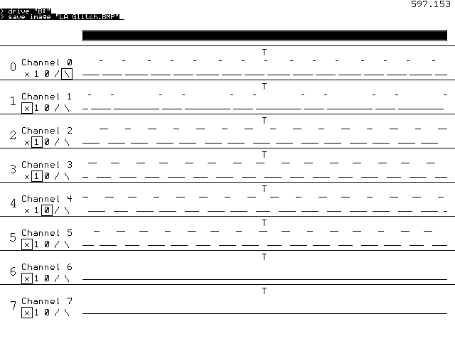

As suggested by Peter, the logic analyzer project get's a new thread.
Pluto: maybe this is of interest to you. PAN and SCAN (zoom and scoll) is working on the cursor keys. The trigger indication is not yet live, but you can set the trigger typing "t". Changing the sampling rate under UI control is next.
Current focus is on:
1/ faster plotting
2/ trigger jitter

Sub generate_test_signal
' Test signal: Three phase motor drive - picomite V50706+
' runs autonomously on GP0...GP5 50Hz
 SetPin gp0,pwm  'CH 0a
 SetPin gp1,pwm  'CH 0b
 SetPin gp2,pwm  'CH 1a
 SetPin gp3,pwm  'CH 1b
 SetPin gp4,pwm  'CH 2a
 SetPin gp5,pwm  'CH 2b
 PWM 0, 50, 11.11, -88.88, 1, 1
 PWM 1, 49, 33.33, -66.66, 1, 1
 PWM 2, 50, 33.33, -66.66, 1, 1
 PWM sync 0, 100/3, 200/3
 Pause 20
End Sub

Posted: 09:20am 28 Jan 2023
Intermediate version
comment "generate_test_signal" out and you have a 6/8 channel LA
on VGA you may want to disconnect and disable audio for channel 6 and 7
cleanup of code must happen
trigger must be extended with edge trigger
change:
pan/scan with arrow cluster
sampling rate with +/-
trigger with t
enjoy

Displayed pulse widths seem to fluctuate a bit.
Posts: 6187
Posted: 01:42pm 28 Jan 2023
In this version, the display shows all samples when you zoom in maximum. When your sampling rate is 10kHz (100us) a signal of 120us can appear as 1 sample, 100us, or as 2 samples 200us. Depending on the exact moment of the first sample. To minimize this effect the trigger program runs fastest.
This effect will be less if you sample faster (press + key few times.)
When you zoom out, you will start seeing aliasing effects, since the display will show 1 in 4 or 1 in 8 samples. The LA samples 4096 samples, but shows only 128 or 256 at a time.
I hope this explains a bit...
P.s. if you have optio audio set, channel 6 and 7 will show aliasing signal of 44kHz. Only when you turn the samping up to 1MHz it makes any sense. At the moment you can not trigger on channel 6 and 7.

This is version 0.12 of the logic analyzer.
It is a major re-write of the trigger engine. I have to put it through it's paces, but think it is functional enough.
From here I hope the changes will be cosmetic.
User interface:
arrow keys zoom in and out, and move the visible window through the buffer
with +/- you increase/decrease the sampling rate
setting the trigger is still typing in a string of characters.
Default setting now is for 8 channels, but you can change the value of maxh_chan_no% in line 25 (5=GP5, 7=GP7).
todo:
- trigger changes
- nice top of screen graphics
- programmable channel names
future:
- I2C decoder, SPI decoder, UART decoder

'program pio1.0 : sampler
 PIO program line 1,0,&hE081           'SET GP22 output
 PIO program line 1,1,&hE001           'SET GP22 high
 PIO program line 1,2,&h80A0           'PULL block
 PIO program line 1,3,&hA027           'mov(x,osr)
 PIO program line 1,4,&h4001+max_chan_no%  'IN pins 6/8
 PIO program line 1,5,&h8000           'PUSH noblock
 PIO program line 1,6,&h00C4           'JMP (GP22) 4
 PIO program line 1,7,&h4001+max_chan_no%  'IN pins 6/8
 PIO program line 1,8,&h8000           'PUSH noblock
 PIO program line 1,9,&h0047           'JMP (X<>0) 7 X--
'initial trigger program: run continuous (set GP22 low)
 PIO program line 1,10,&hE000          'set GP22 low
 PIO program line 1,11,&h000B          'jmp always to itself
'configuration PIO 1.0
 f0=4e4                             'PIO run at 10kHz
 p0=Pio(pinctrl 0,1,0,gp0,,GP22,)   'IN base = GP0, SET = GP22
 e0=Pio(execctrl gp22,1,9)          'wrap 9 to 1, gp22 is conditional JMP pin
 s0=Pio(shiftctrl 0,0,0,0,0,1)      'shift in through LSB, out is not used
'configuration PIO 1.1
 f1=63e6                            'PIO run at 63MHz
 p1=Pio(pinctrl 0,1,0,gp0,,GP22,)   'IN base = GP0, SET = GP22
 e1=Pio(execctrl gp0,10,30)         'wrap 30 to 10
 s1=Pio(shiftctrl 0,0,0,0,0,1)      'shift in through LSB, out through LSB
'write the default configurations
 PIO init machine 1,0,f0,p0,e0,s0,0    'start address = 0
 PIO init machine 1,1,f1,p1,e1,s1,10   'start address = 10 (0x0A)
End Sub
'print the traces on the serial output
Sub scrnprint st%,sp%
'print section st% to sp% of the linear array to serial (screen)
 Local z%,y%,x%,stp%,mask%,one%,eras%,bit%
 stp%=Int(0.5+(sp%-st%)/128)
 Timer =0
 For j%=0 To max_chan_no%
   z%=j%*48+85
   mask%=2^j%
   Box 112,z%-17,524,14,,1,1  'erase
   For i%=st% To sp% Step stp%
     bit%=((unpacked%(i%) And mask%)=0)
     one%=20*bit%
     Eras%=20*(1-bit%)
     x%=116+4*(i%-st%)/stp%
     y%=z%+one%
     Line x%,y%,x%+4,y%,,0
     y%=z%+eras%
     Line x%,y%,x%+4,y%,,1
     If i%=length% and tr%(j%)<>0 Then Print @(x%-4,z%-17) "T"
   Next i%
 Next j%
 'Print @(570,0) Timer
End Sub
'show bar st%-sp% in relation to full range 0-samples%
Sub show_zoom
 Local stp%
 Box 116,42,513,16,,0,1             'full buffer
 stp%=samples%/512
 Box 117+(st%/stp%),44,(sp%-st%)/stp%,12,,0,0
End Sub
'from the tr%() array create the trigger program for PIO 1.1
sub trigger_create_program
'when there is an edge trigger, it is placed at start of the program
'after that the logic conditions are added
'there can be only 1 edge trigger in this engine, the first in string
 local trigger_start_address%, trigger_end_address%, i%
 trigger_start_address% = 10            'address &h0A
 trigger_end_address%= 31               'last location PIO program
 write_pio%=trigger_start_address%
'check edge trigger, for edge trigger use the PIO WAIT GPx instruction
'a falling edge is WAIT GPx=1, WAIT GPx=0. Rising edge WAIT GPx=0, WAIT GPx=1
 for i%=0 to max_chan_no%
   if tr%(i%) > 2 then
'found edge trigger for channel i%
'below code can be optimized further
     if tr%(i%)=3 then     'rising edge
       inc_write_pio &h2000+i%
       inc_write_pio &h2080+i%
     else                  'falling edge
     end if
     i%=max_chan_no%                 'search no further, skip the rest
   end if
 next i%
'check the static conditions. This shifts data in the ISR, copies to OSR
 inc_write_pio &h4001+max_chan_no%   'IN ISR 6/8
 inc_write_pio &hA0E6                'MOV ISR->OSR
'Each input processed by reading a new bit from OSR and checking it
'edge triggered pin is skipped (first one is processed, rest is ignored)
   select case tr%(i%)
     case 0,3,4                      'x / \ do nothing, shift bit out into Y (not used)
       inc_write_pio &h6041          'OUT OSR->Y 1
     case 1                          '1
               inc_write_pio &h6021          'OUT OSR->X 1
               inc_write_pio &h002A          'trigger GPx=1
     case 2                          '0
               inc_write_pio &h004A          'trigger GPx=0
   end select
 next i%
'when all triggers are true, we set GP22 low as trigger for the sampler
 inc_write_pio &hE000                'set GP22 low
 inc_write_pio &h000A                'jmp top (needed when memory not full)
'print @(10,10) write_pio%
' maximum program length is:
' without edge trigger: 2 (shift in) + 8 * 2 (8 channels) + 2 (trigger+jump) =  20
' with edge trigger: 2 (edge) + 2 (shift in) + 7 * 2 (7 remaining channels)
'                                       + 1 (skipped edge) + 2 (trigger+jump) = 21
' start addres = 10, end = 31 -> 21 will always fit. No check nor discard needed.
end sub
'this programs 1 PIO line and advances to the next line
sub inc_write_pio instr%
 pio program line 1,write_pio%,instr%
 inc write_pio%,1
end sub

Hi Pluto,
I have taken your code and will paste it into the logic analyzer. When there is anything you are working on to improve, just let me know. I have done what you suggest, and pasted it in the logic analyzer.
My target is to print the decoded text (start/stop/read address/R/W) in the green bar above the waveform at the location where it is in the serial stream.
In my logic analyzer (I progressed to version 0.13) I have edge trigger implemented and single trigger. It is not yet finished, but do you want it to base the decoder on , I can post a zip.
I very much like this way of working together. DMA from Peter, graphics from Martin, I2C decoder from you, PIO engine from me.... A true community project.
User interface:
+/- to adapt sampling rate
s = single trigger
r=repeated trigger (run)
0...6 toggle through trigger options for that particular channel.
It may not be stable, please provide feedback.
P.S. it is default 6 channel now
known bug: when the DMA times out (at 21MSps this is after 2 minutes) and you press a key, you get an error message and the program stops. If you are running 500kSps, this happens after 1 hour waiting for a trigger.
