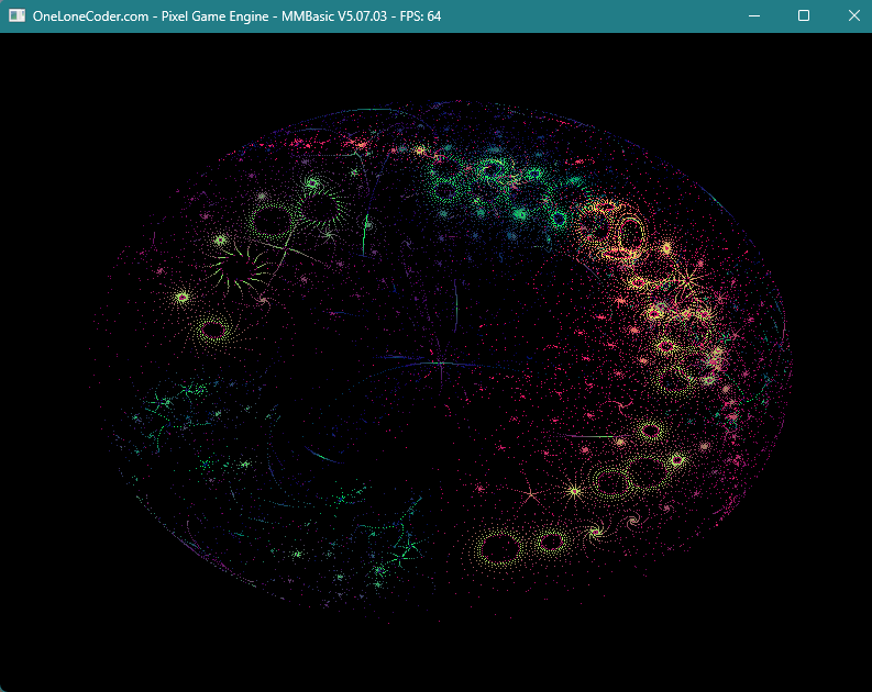

Needs the speed of MMB for Windows
I believe the original code was written by Paul Dunn - developer of SpecBas.
It has done the rounds of many languages including QB64 and PureBasic
'bubble universe MMB4W
 OPTION EXPLICIT
 OPTION DEFAULT FLOAT
 DIM r,t,u,v,x,n, TAU
 DIM INTEGER i, j, hw, hh, col
 MODE 1
 n = RND()*100+300
 TAU = 6.283185307179586
 r = TAU / (RND()*100+235)
 hw = MM.HRES / 2
 hh = MM.VRES / 2
'Cls(RGB(0, 0, 0))
 PAGE WRITE 1
 DO
   CLS(RGB(0, 0, 0))
   FOR i = 0 TO n
     FOR j = 0 TO n
       u = SIN(i + v) + SIN(r * i + x)
       v = COS(i + v) + COS(r * i + x)
       x = u + t
       Col = RGB(i AND &hFF, j AND &hFF, 99)
       PIXEL hw + u * hw * 0.4, hh + v * hh * 0.4, Col
     NEXT
   NEXT
   t = t + 0.01
   PAGE COPY 1 TO 0
 LOOP UNTIL INKEY$ <>""

Very beautifull.
There was a thread about this before, it also runs on the picomite. Although not near as beautifull as on mmb4w
