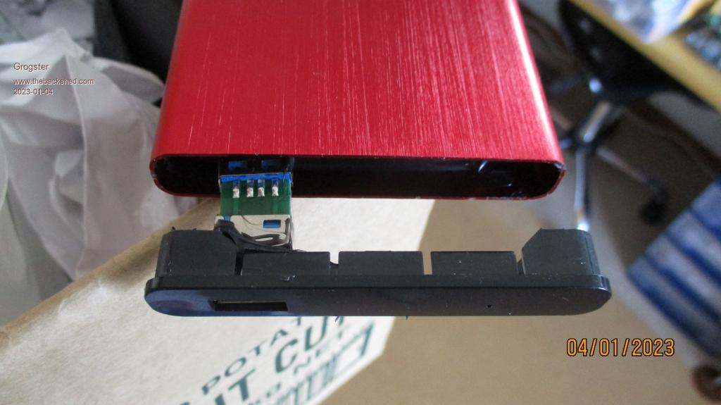

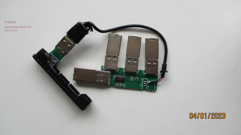

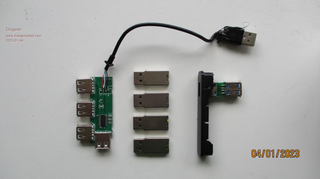

This one is NOT mine - I can spot a scam, but I thought I would find out what was inside.
A friend-of-a-friend sent me a new external HDD for me to copy some of my media library onto just prior to Christmas.  As I am now in quarantine till Sunday with the coof, I found some time to play about with it.
When plugged in, it identified itself as a HDD, but the first warning sign of something odd, was it showed up as FOUR 2TB USB HDD's.
I bet many of you already know where this is going....
Drives F, G, H and J.
Firstly, it is impossible to get a new USB3 HDD that is already pre-partitioned, unless someone has carved it up before it got to you, and 2nd - 4x 2TB?!
So...8TB in a 2.5" external case, for what I soon found out cost the guy $50 on ebay.
Ahhhh.....
Making more sense now!
Besides the fact that you can't even buy a 2.5" HDD of 8TB capacity in the first place, even if you COULD.......fifty bucks?!
BTW, the largest 2.5" spinning HDD I could find new from the likes of Seagate or WD etc, was 4TB @ NZ$333 each. Link, if interested
Half the capacity and roughly seven times the price - for genuine capacity, that is.
Obviously, this USB3 thing is a fake drive, and I passed that along to the friend-of-a-friend, but it is the uneducated that are the ones that get taken by these scams.

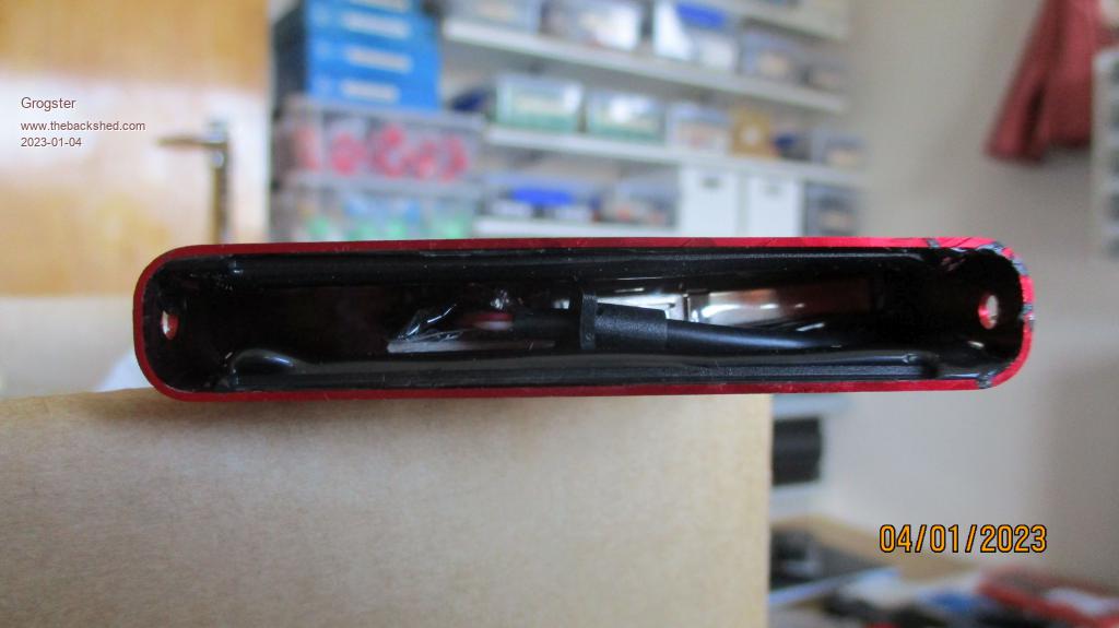

Cracking it open revealed:
So, using a USB3 socket, but very much a USB2 speed arrangement inside, so is slow AND will not have anywhere near the capacity, and gawd only knows what happens to your data if written to this thing.
This scam is probably actually quite lucrative, considering they are probably building it for about $10 including case, and selling it for $50 + postage per unit.

Just idle curiosity, have you determined the actual capacity of those thumb drives?
Edit
Many years ago I bought a 32GB that worked at first then started scrambling files. Re-formatted and started writing to it, checking the first files after each write. It worked ok up to about 7GB then started messing things up. Probably an 8GB chip with a fake ID.
Edited 2023-01-04 15:42 by phil99
Posts: 10074
Posted: 07:16am 04 Jan 2023
No, never even bothered to plug one of the four in.
It will be reporting as 2TB - which again, is not possible in current USB flash-drive flavours.  You CAN get 1TB flash drives for NZ$305 each.... link
As your edit says, they WILL be some kind of cheap flash-drive with a fake ID to trick the computer into thinking it has much more then it really has.
Would not surprise me if they were 2GB drives ID-ing as 2TB.
In any event, not something to use for anything anyway, as they are also totally unbranded.  I did crack one open to have a look inside, but the build-quality was so horrible, I just swept the entire collection of bits into the bin once I had take the photos and posted the thread.

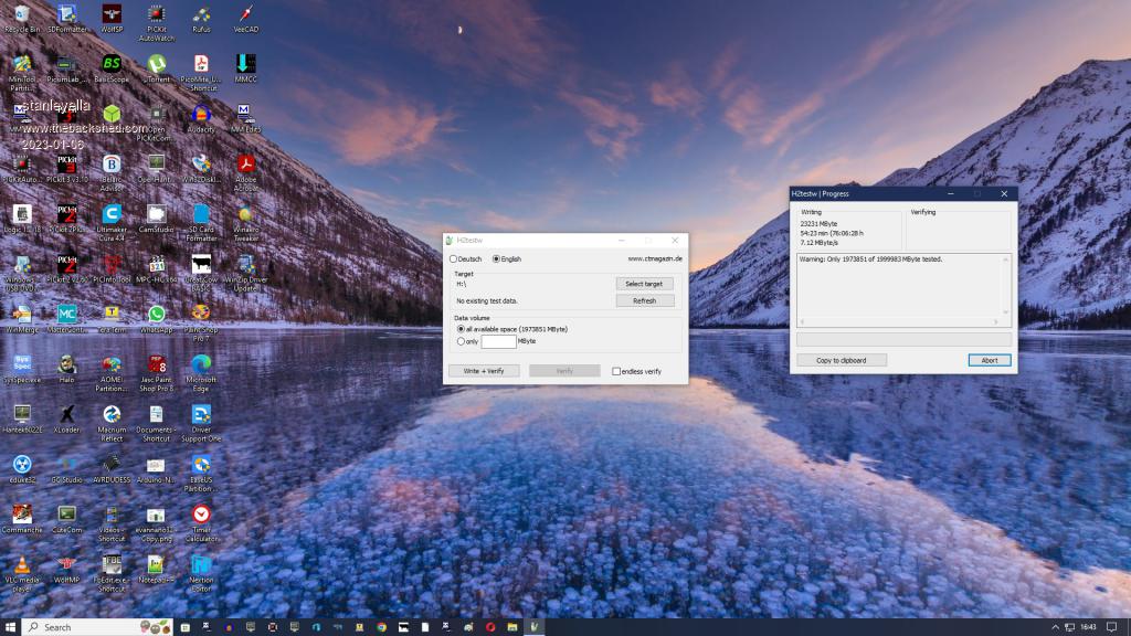

stanleyella
Joined: 25/06/2022
Posts: 2807
Posted: 04:42pm 05 Jan 2023
My win 10 pc's have only usb2. Should it take 70 hour? :)
My rpi400 has usb3 but will the linux version work on it?
stanleyella
Joined: 25/06/2022
Posts: 2807
Posted: 06:34pm 05 Jan 2023
Warning: Only 33772 of 1999983 MByte tested.
The media is likely to be defective.
20.2 GByte OK (42493056 sectors)
12.7 GByte DATA LOST (26672000 sectors)
Details:2.3 MByte overwritten (4866 sectors)
0 KByte slightly changed (< 8 bit/sector, 0 sectors)
12.7 GByte corrupted (26667134 sectors)
65 KByte aliased memory (130 sectors)
First error at offset: 0x0000000510b90000
Expected: 0x0000000510b90000
Found: 0xffffffffffffffff
H2testw version 1.3
Reading speed: 17.7 MByte/s
H2testw v1.4
If it's too good to be true.... etc.  :)

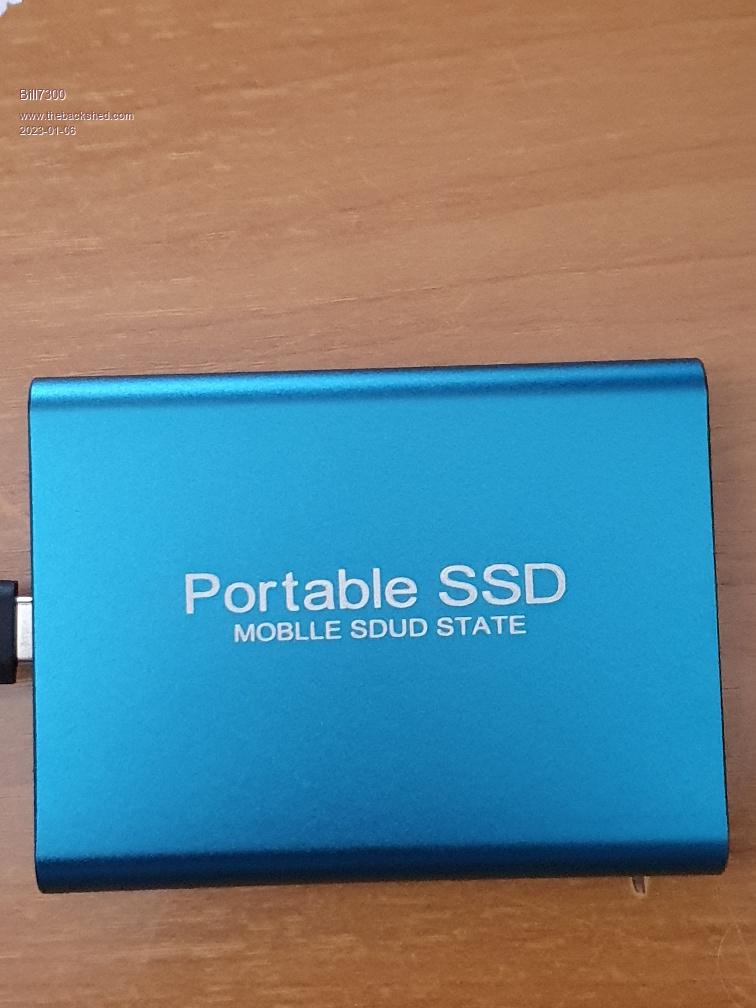

Bill7300
Joined: 05/08/2014
Posts: 161
Posted: 11:43pm 05 Jan 2023
Not quite the same device but one here is very similar. The description under the "Portable SSD" should have been a clue. Obviously "MOBILLE SDUD STATE" looked sufficiently close to "MOBILE SOLID STATE" to that non-English speaker.

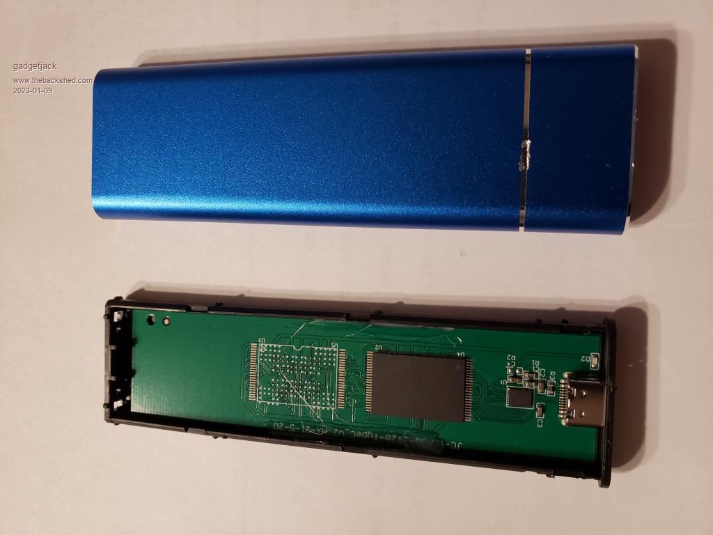

gadgetjack
Joined: 15/07/2016
Posts: 240
Posted: 11:26pm 08 Jan 2023
I remembered getting one similar to this as a present a few months ago. Was told it was 2 terabyte. I laughed and put it on a shelf. After reading this thread , I dug it out and tested it for a laugh. Sure enough it says 2 terabyte , but fails after about 32 gig of testing with fake finder software. And very SLOW reading. Says bluetooth 3 but I dont think so.

  Bill7300 said  Not quite the same device but one here is very similar. The description under the "Portable SSD" should have been a clue. Obviously "MOBILLE SDUD STATE" looked sufficiently close to "MOBILE SOLID STATE" to that non-English speaker.
SDUD is right. Definitely a DUD!
