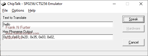

Why the renaming? Then you can convert text to the appropriate phonemes very easily with this tool here (https://web.archive.org/web/20210211045521if_/http://www.speechchips.com/downloads/chiptalksetup.exe).
...I probably should have renamed the files to the format "0xXX" rather than "XXh" - I can still do that...

Yes, you need the files from the linked ZIP. It was not my idea - ChipTalk (from the above link) works in the same way.
