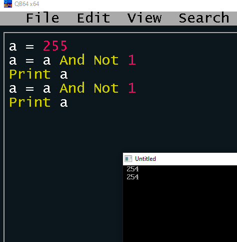

Example: I am expecting a=254
a=255
a=a and not 1 'just want to reset b0
print a
The result is zero

If you and with 254 you will preserve the rest of 'a' but reset b0
a = a and 254

That's QB64
@matherp: That works! Cheers
Not in my DOS version though but it's not the latest.
