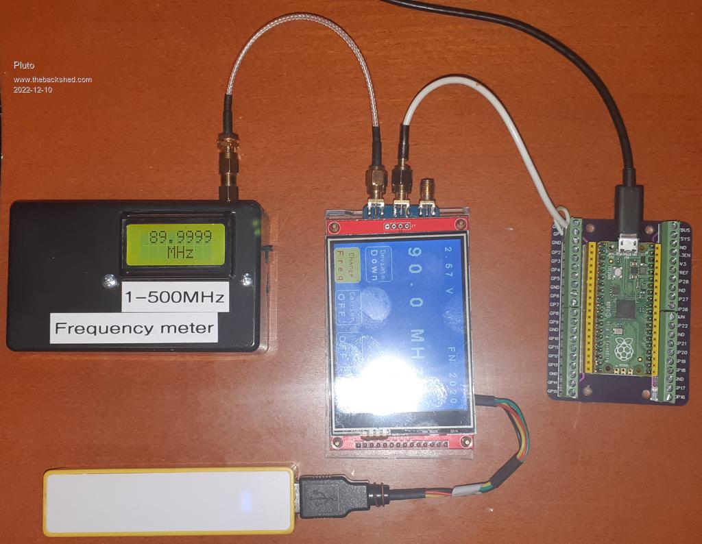

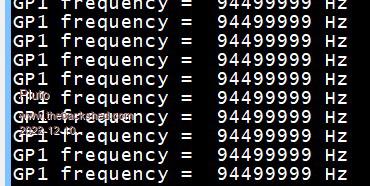

-Using the PWM as input (15MHz). The measured frequency is 15.12MHz measured by your new program and the same result with a purchased low resolution 5-digits meter. In the program listing you say it should be 15.75MHz.
-When using DDS Signal Generator by Geoff https://geoffg.net/SignalGenerator.html, I get at frequencies above 400kHz readings that are 10 Hz high. It is fluctuating between 400000 and 400010. At 3MHz it is 30Hz high. Not a problem at all for me; just wanted to report to you.
-When disconnecting the signal source from the running meter, it continues to show the last measurement. Could be a source for confusion when used in an application. Any possibility to get it to allways show 0Hz without input signal?

#1: the actual frequency from the PWM depends on it's clock. In my case the CPU runs at 252MHz. You may be running a different clock. With 252MHz, the 15MHz command send to the PWM translates to 15.75MHz, which is exactly 63MHz divided by 4.
Important is that what your external frequency counter says is identical to what the picomite says...
#2: need to think on that one. When there is absolute no input clock in the gate timeframe, the PIO code waits forever, and never pushes a value into the FIFO (instruction at address 8 or 9). So the FIFO keeps showing the last valid value. It may need an extra logic signal...
#3: that is why I ask. Don't want to spend a lot of time when no-one even reads it.
About the DDS generator: the gate time in my code is 0.1second. That measn that fluctuations between 400000 and 400010 are actually only 1 count. Change gate_time to 1, and you will get more accurate results.

Volhout, some more testing of your latest PIO code ......
@CPU378MHz, f1=378e6, pwm 1,90000000,,50:
94.5MHz "confirmed" by FM-radio. 10cm wire on the GP3 makes an FM transmitter with receivable signal >10m indoors.
An other frequency meter (cheap) also shows 94.5015MHz.
