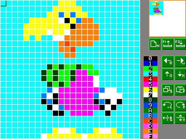

To make the work a little easier I wrote a small sprite editor.
Sprites can be loaded in the own program by Using the SPRITE LOAD Command
It is controlled via the keyboard:
Cursor to select the Pixel
0 to f  set the Pixelcolor
F1      Load Sprite
F2      Save Sprite
n       New Sprite
q w o k move the Sprite
s       save to Clipboard
p       past from Clipboard
l       Rotate Left
R       Rotate Right
H       Flip horizontal
V       Flip Vertical
Rotation might fail if the Sprite is not squared
Tested on PicomiteVGA and MMB4W
so it should also run on ColorMaximite
Here the Code with some example Sprites:
SprEd.zip
Have Fun
 Mart!n
