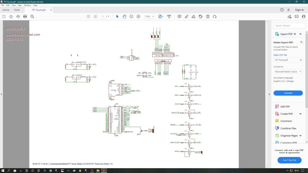

The (PDF) circuit looks like they are SPI, but I've no experience of these.

Rig one up on its SPI pins, use the ILI9341 driver and see what happens. It looks like you should be able to get the display and probably the SD card working. It'll be interesting to see what happens. :)  By changing a link on the display you should be able to get control of the backlight too so that you can switch it off and on or PWM it. The necessary transistor is in place.

It looks compatible but not sure what logic levels it uses from the circuit.
Posts: 8978
Posted: 05:30pm 14 Oct 2022
The display has a 5V input that feeds a 3V3 regulator (U3). The buffers U2 and U4 are being powered at 3V3 so they can accept 3V3. Each input has a 3K3 series resistor so I assume that inputs can also accept 5V. Outputs will be at 3V3, but that's within tolerance for 5V TTL.
A further regulator produces 2V8 for the display logic and backlight.
The base of the backlight transistor has 1K on it and is then linked to 5V to turn it on. Moving the on board link connects it to PD7 instead so it can be connected to a Pico output to control it.

Compare the schematic to the PCB layout and you will see which pins to use, including the RESET which you were missing.
