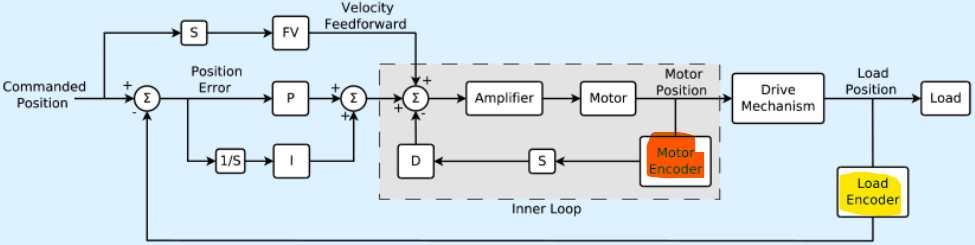

No, the PicoMite is the front-end to my Parallax P2-based motion controller.
The objective is to provide a proper closed-loop-servo alternative to all of these stepper systems
CNC = Computer Numerically Controlled
I regard open-loop steppers: Computer Numerically Commanded
No feedback = no "control".
In fact, my method is to utilize "dual-loop-feedback". The device highlighted in red is what is typical and provides loop stability but the controller is never aware of mechanical backlash. Maintenance personnel can't understand why parts are varying when the controller always reports "axis is within tolerance"
I prefer to use both the red and yellow highlighted devices to provide stability and backlash immunity (within reason).
Craig
