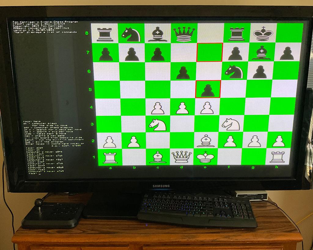

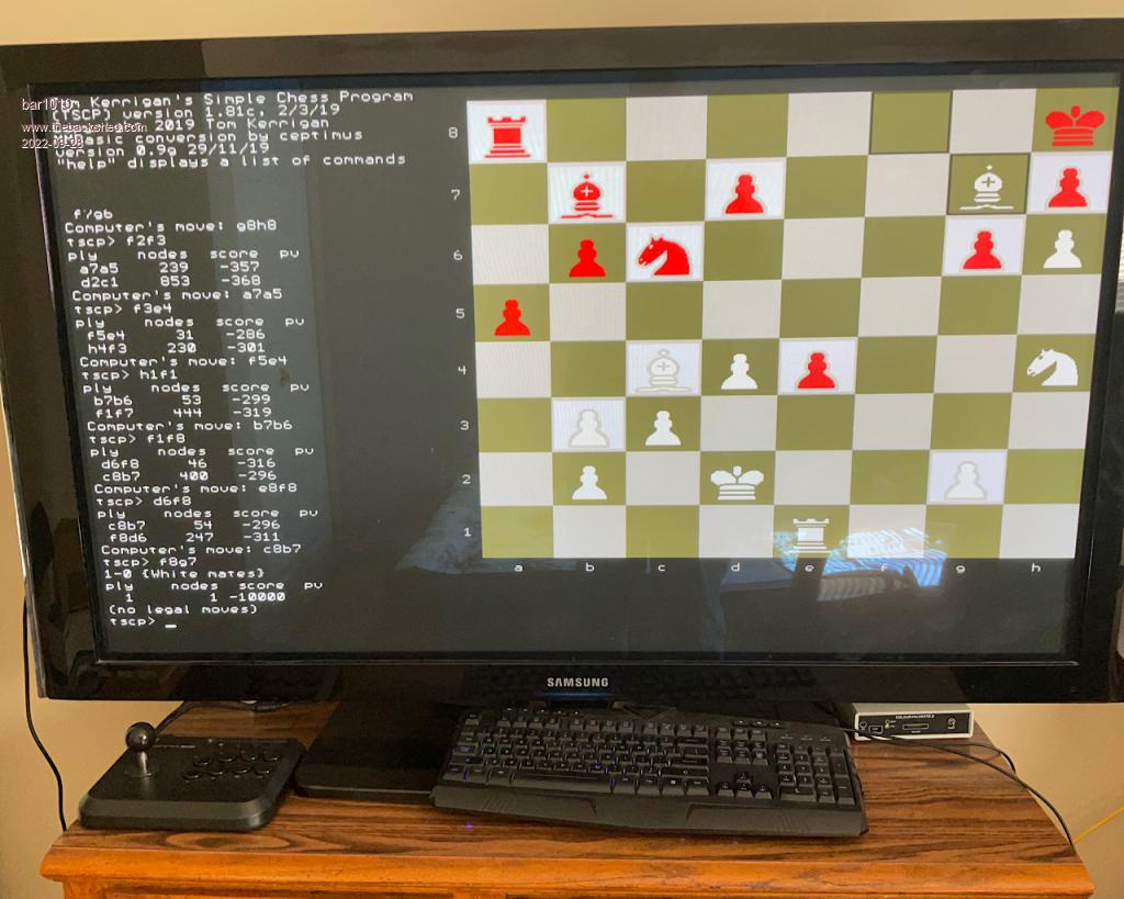

TSCP Chess for Color Maximite 2
TSCP Chess.zip

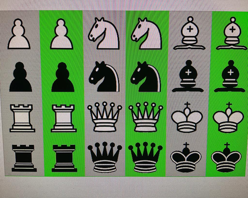

Here is a new BMP file that I might use for higher resolution piece graphics.  The squares are 115x115 pixels compared with 60x60 pixels for the current version.

Now have modified TSCP Chess to have a new pieces set and higher resolution.  The original resolution was 800x600.  The new resolution is 1280x1024.  The text on the left side of the screen is quite small though.  Might soon post an updated ZIP file after more testing.

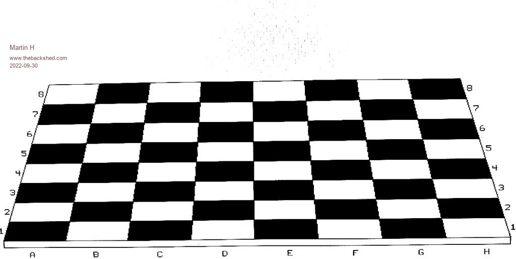

how about a Picomite Port with a GUI in "Chessmaster 2000" Style
here for 640x480x2 but can be downscaled for 320x240x16
MODE 1
CLS RGB(White):Colour 0
Line 72,146,568,146:Box 8,402,625,12
Line 72,146,8,402:Line 568,146,632,402
For y%=0 To 7
Line 72-y%*8,146+y%*32,568+y%*8,146+y%*32
 n%=8*(7-y%)
 Text 2+n%,32+124+y%*32,Str$(8-y%),,,,0,RGB(White)
 Text 632-n%,32+124+y%*32,Str$(8-y%),,,,0,RGB(White)
Next
For x%=0 To 7
Line 72+x%*62,146,8+x%*78,402
Next
For y%=0 To 7
 For x%=0 To 7
   If (x%+y%)Mod 2 Then
     p1X%=(72-8*y%)+x%*(62+2*y%)
     p1Y%=146+y%*32
     p2x%=(72-8*y%)+(x%+1)*(62+2*y%)
     p2Y%=p1Y%
     p3X%=p1X%+(-8+x%*2)
     p3Y%=p1Y%+32
     p4Y%=p3Y%
     p4X%=p2X%+(-8+(x%+1)*2)
     Triangle p1X%,p1Y%,p2X%,p2Y%,p3X%,p3y%,0,Fill
     Triangle p3X%,p3Y%,p4X%,p4Y%,p2X%,p2y%,0,Fill
    EndIf
  Next
Next
F$=String$(9,32)
T$="A"+F$+"B"+F$+"C"+F$+"D"+F$+"E"+F$+"F"+F$+"G"+F$+"H"
Text 40,420,t$,,,,0,RGB(White)
'no comment
