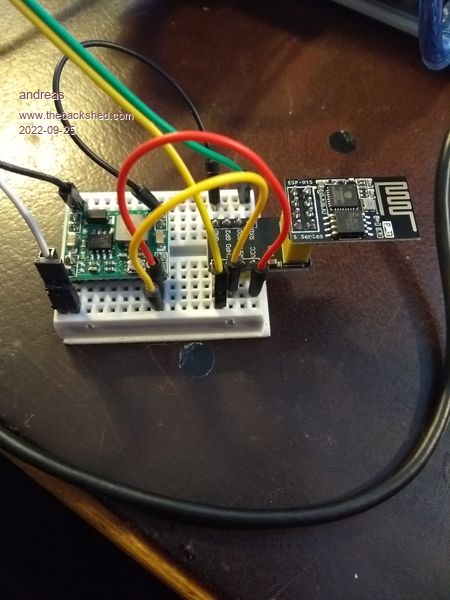

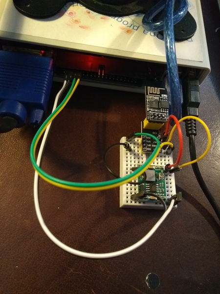

Hello,
I wanted to connect the Colour Maximite 2 to the internet.
My setup is an ESP8266 chip connected to ports 4,6,8,10 of the CMM2. Pin 8 & 10 are for TX/RX of com1: and pin 4 & 6 for VCC and GND. In between I put a dc-dc converter which generates 3.3 volts for the esp from the 5 volts comming from the cmm2. the TX/RX are connected cross over ("null modem") TX Cmm2 to RX ESP and vice versa. The ESP chip enable pin is sourced from the 3.3V comming from the buckboost converter.
a tiny "terminal program" gives the possibility to key in ESP8266_AT commands to test all the features:
That seems like a lot of work. Do you only have a 1st Gen CMM2? The 2nd Gen version has holes right on the main board to mount the ESP8266 (in my case a socket for it for easy replacement if necessary)

Yes I'm using a 1st generation CMM2 build in november/december 2020 - at that time I've got the CoreH743I, STM32 STM32H743IIT6 MCU core board for 29€
I was not aware of the ESP-01 wireless chip until I read in this forum about that. I started looking at amazon and found two parts - the chip itself and the "breadboard" adapter. When the chip arrives I had no information how to use it and looked for the handbook and sample code. the rest was a matter of two days.
Now I'm playing with an #include library of code to use internet connections within MMBASIC. This can start with simple things like setup wifi connections, terminal software etc. up to an mail client or even a lynx like browser.
