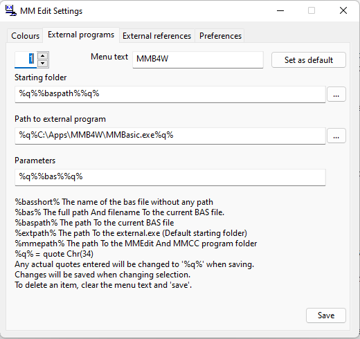

MMEdit5
 Action/Edit list
 Change the spin-box up to the next available spot That will be '1' if you haven't added any other external programs.
 Menu text = MMB4W
 Starting folder = %q%%baspath%%q%
 Path to external program = %q%C:\Apps\MMB4W\MMBasic.exe%q%
 You will have to edit the path to point to your MMBasic.exe location
 Parameters = %q%%bas%%q%
 You might as well click on "set as default" so the run in DOS button changes to MMB4W

Working beautifully
Many thanks, Jim.
