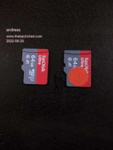

I received a new sdcard and formatted it to FAT32 because I wanted to use it within a HW-125 sdcard reader connected to a pico w.

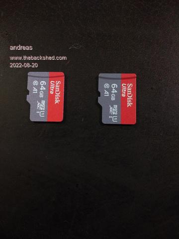

The sdcard received (right side) was exactly the same as I had already and which worked fine in the past (left side).
I could see both cards inserted into an adapter in my main PC, I could read and store data on both of them - the cards were ok.
Then I inserted the new card in to the Pico sdcard reader HW-125 and it didn't work:
? mm.info(sdcard) -> Not present
files -> Error: SD card not found
Now I tried several sizes 2GB, 32GB and formats FAT32, extFAT, ext4 no success.
Because the cards both worked within the PC but the new one not with the HW-125 I added a tiny red marker ("Klebepunkt" in german) to the new card (right side) to make it a little thicker - possibly only a 1/10 mm:
This solved the problem! Now the card works within the reader.
That means the contacts within the reader had no contact to the card. The paper clip makes the card slightly thicker and the pressure in direction to the reader contacts is higher.

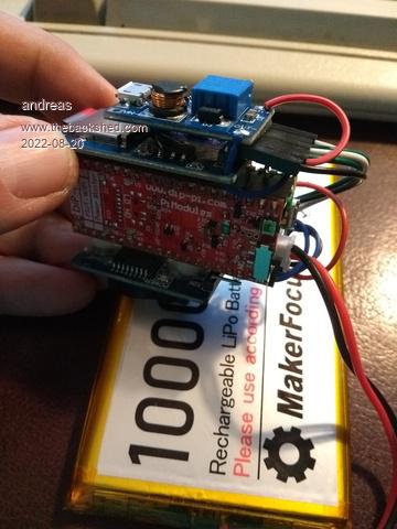

Update: Because the red dot gave better results but unfortunately not perfect results (there were still "no sdcard" events) I did another modification.
I added a "step up" module (2$) which generates a stable adjustable 5.00 volts out of the lower 4.22 volts of the full akku. I took VSYS of the pico (pin 39) as input for the step-up and then the 5 volts output into the card reader. Now it is really working stable.
The test-procedure was an autorun programm which writes on the sdcard. After 20 seconds I switched off the "mini-pc" and put the sdcard into my PC to read the values. I repeated that several times.
So my result is: Contacts have to be checked, 100 MHz cpuspeed and the sdcard voltage should be 5 volts to get a stable working sdcard. The funny thing is, that the sdcard has a buckboost chip which generates 3.3 volts from the 5V input voltage
-andreas

Seems rather logical. Maybe the buck-boost has a drop-out issue due to the lower difference between input and output voltage when running at 4.22v.
