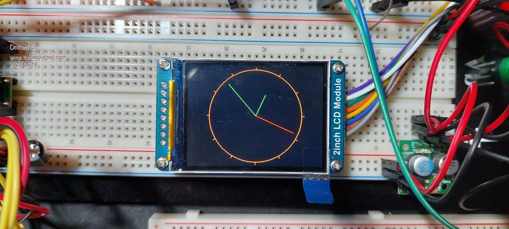

While watching a youtube video about a guy coding an analogue clock on a led matrix I got the idea to try coding an analogue clock on the picomite for an SPI LCD panel.
My setup is a PicoMite with an I2C RTC and an ST7789 320 x 240 SPI panel.
After a few hours of trial and tweaking I came up with the following:
The clock is scalable and colours customizable.
It was a fun little project and a bit of practice for me.

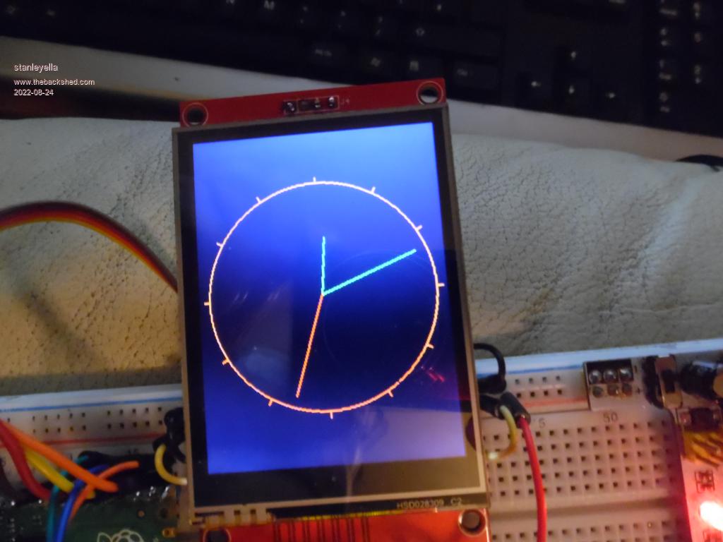

I had to comment
'----------get time from I2C RTC----------'
'RTC gettime
'waitloop:
'If Val(Mid$(Time$,7,2)) = 0 Then GoTo waitloop
Because I do not have it and gave an error. It now works.
clocks are a good way of learning mmbasic trigonometry.

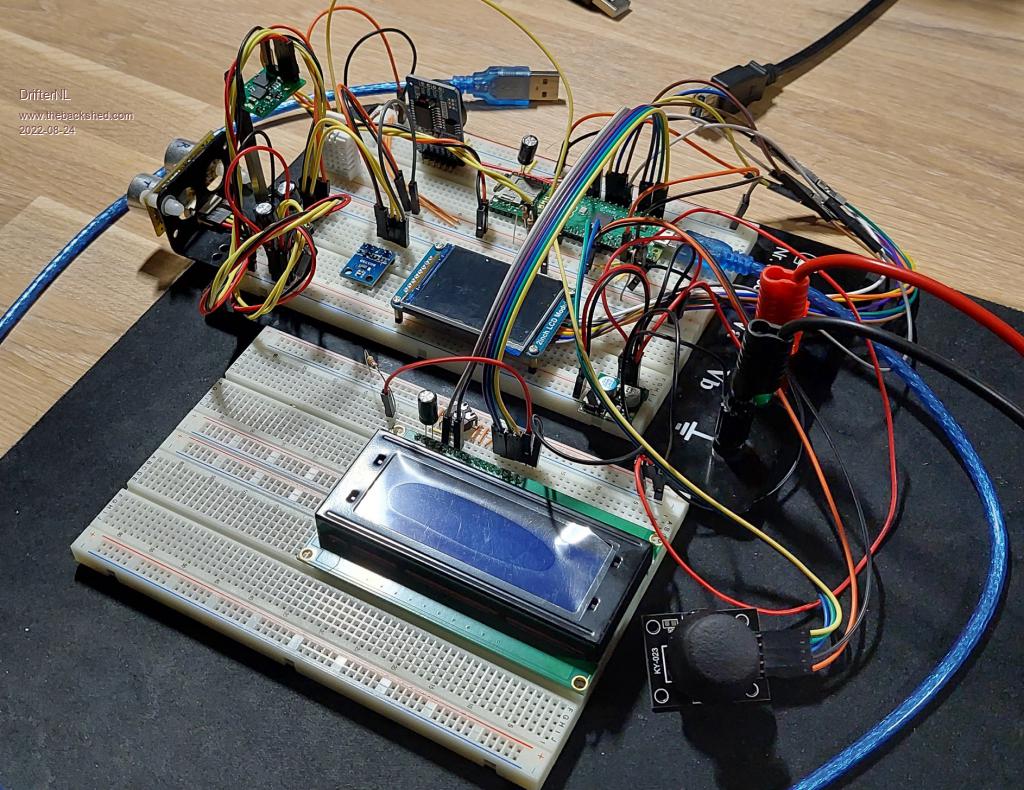

  stanleyella said  @DrifterNL
Another bread board user , It is fast and you can fix mistakes easier than soldered vero board, You do not need a pcb to have fun.
True, but if I may make a suggestion, use solid core jumpers for critical devices like an SD card reader otherwise one wrong move and files / data can be corrupted.
Here is my test set-up:

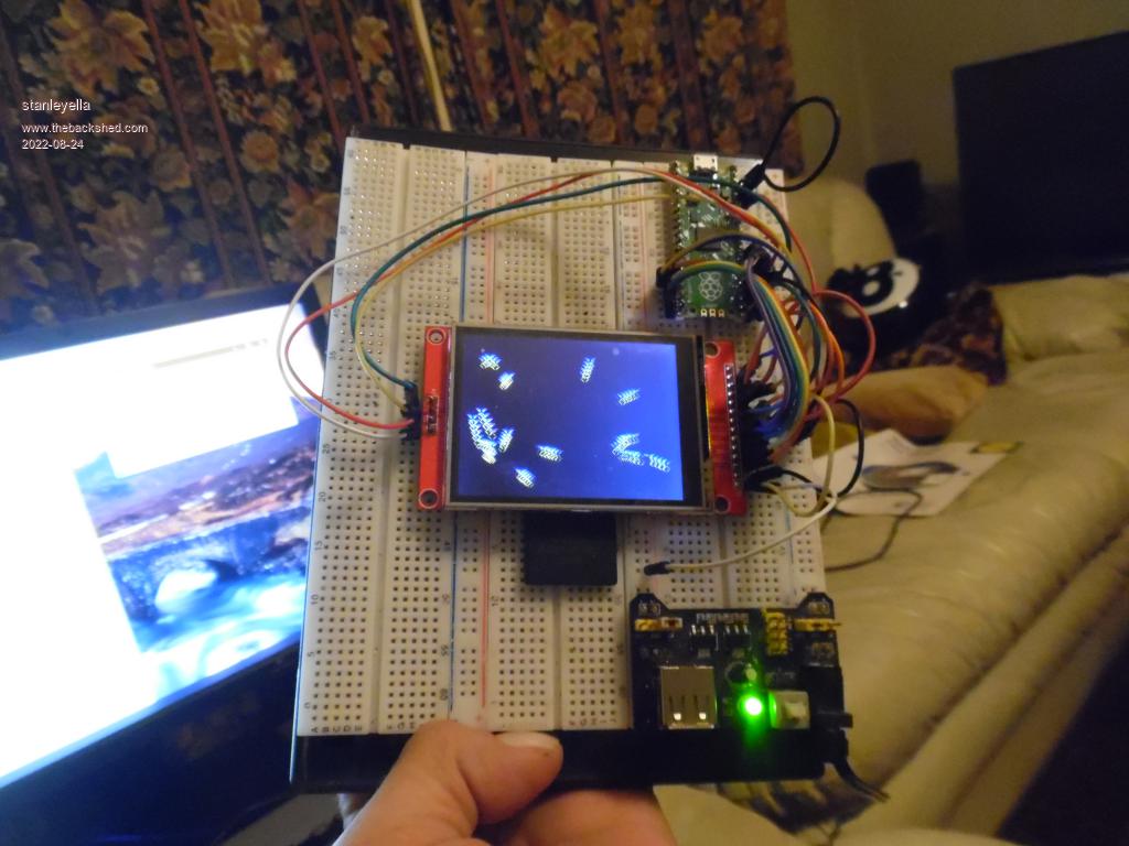

I am going to make this on strip board. my picomite and lcd.
It looks like a birds nest.

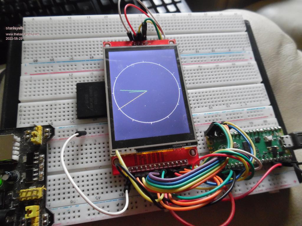

works but screen or is wrong, that is the screen setup- no problem.. Displays time in mmedit chat box??
first program I have seen that uses pi.

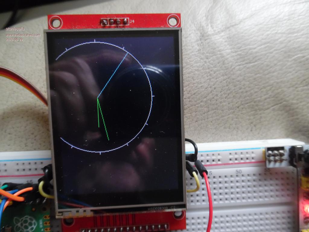

pi is what, integer? sin,cos integer? I thought from other clocks they were floats.
Is pi, sin, cos read from tables?
My other basic does not have rad... and certainly not pi
Posts: 5998
Posted: 08:09pm 28 Aug 2022
Hi,
option default integer means that if you declare a new variable, it will become an integer.
PI (3.1415926535...)is not an integer, it is a pre-declared FLOAT.
SIN and COS are pre-declared FLOAT functions.
The result of multiplying "r0*SIN(...)" is in essence a FLOAT and will be converted to an integer by the LINE command (that only understands integers).
Yip, this is BASIC at it's utmost strength.... You need not worry about this kind of stuff, Basic will solve it for you.
Try this in C and you will do a lot of casting before the sun sets ..... (or ... if you get lazy, you simply declare everything a FLOAT, and do the casting in the LINE statement.....but before you try this on an arduino, know that FLOAT is really slow on the ATMEG328)
