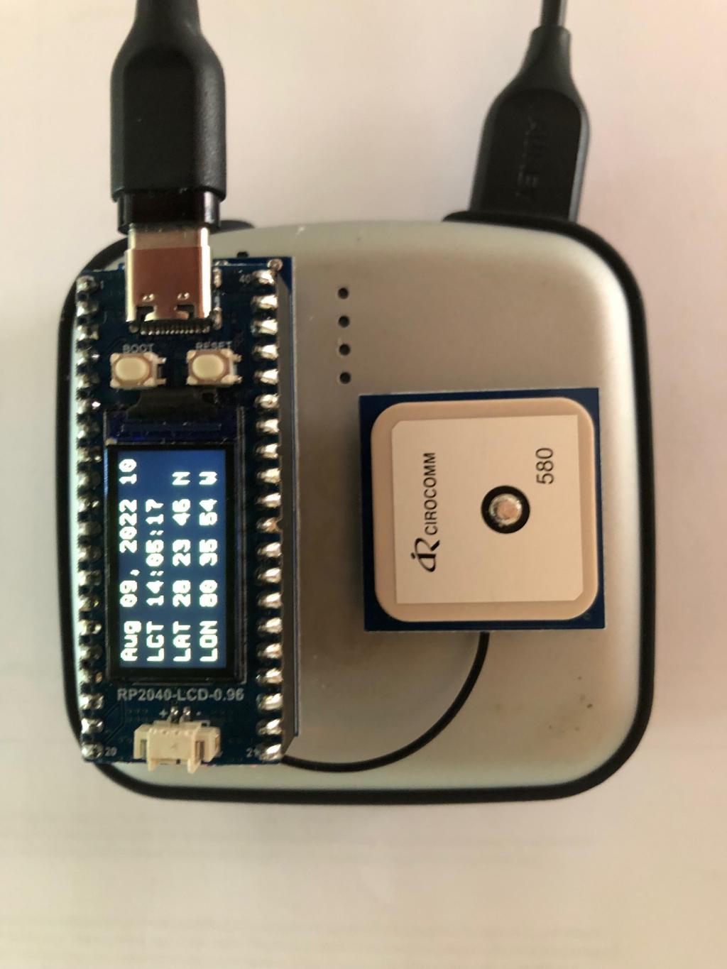

Picture of a minimalist Pico/GPS project. It uses a Waveshare RP2040-LCD-0.96 and a Waveshare Pico-GPS-L76B. The GPS plugs into the Pico/display board.
Powered by a Voltaic battery via USB. The RP2040 has a MM1.25 connector and charging circuit for a battery.
Thanks to Peter for providing the MMBASIC parameters for the display on the RP2040.
